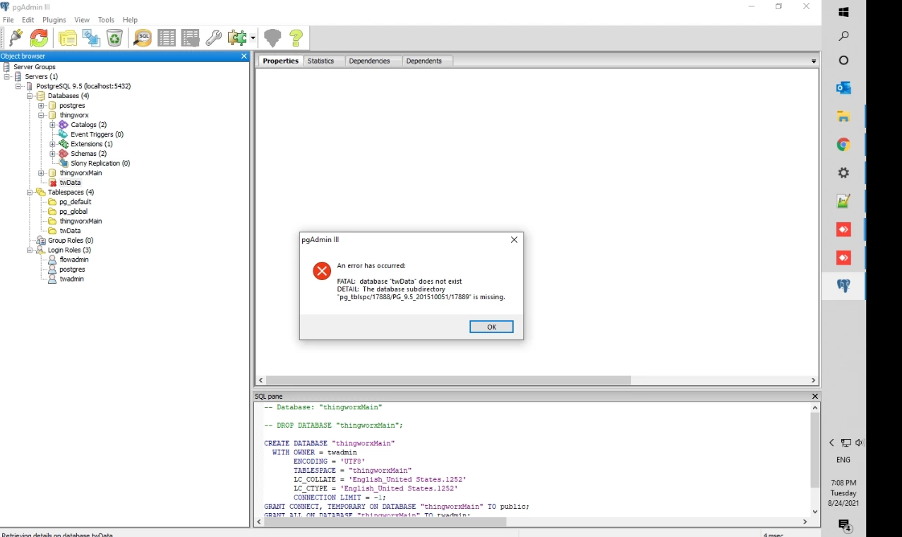

I seen error in twdata of pgAdmin. I attached the image. Does that matters?
And I can see these errors in Application logs:-
2021-08-24 15:40:30.229+0530 [L: ERROR] [O: c.t.s.ThingWorxServer] [I: ] [U: SuperUser] [S: ] [T: main] [message: Connections could not be acquired from the underlying database!]
2021-08-24 15:40:30.255+0530 [L: ERROR] [O: c.t.s.ThingWorxBootstrapper] [I: ] [U: SuperUser] [S: ] [T: main] [message: Unable to initialize and start system: Connections could not be acquired from the underlying database!]
2021-08-24 15:40:30.255+0530 [L: ERROR] [O: c.t.s.ThingWorxBootstrapper] [I: ] [U: SuperUser] [S: ] [T: main] *** CRITICAL ERROR ON STARTUP: Unable to initialize and start system: Connections could not be acquired from the underlying database!
2021-08-24 15:40:30.255+0530 [L: ERROR] [O: c.t.s.ThingWorxBootstrapper] [I: ] [U: SuperUser] [S: ] [T: main] *** Web Application STATE is being set to ERROR! ***
