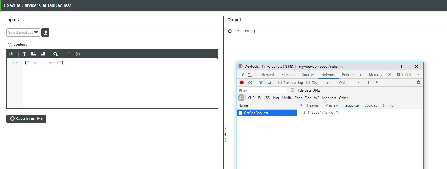

In a service I need to return an error with status code = 500 and return type JSON.

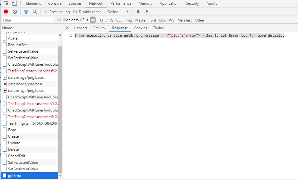

Actually my service returns JSON but the response I really get is "Error executing service getError. Message :: {"test":"error"} - See Script Error Log for more details." and what I want to get is just the JSON {"test":"error"}
I succeeded to have this work if I call a service on a resource but as soon as I call the service of the resource from a service of a Thing it doesn't work.
Any ideas?

My service in the Thing calls this:
if(code >= 500){
	// result: JSON
var result = Resources["JSONErrorResource"].GetBadRequest({
	content: {"plop": "error"} /* JSON */
} else{
var result = {"plop": "ok"};

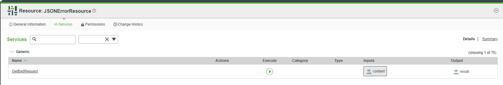

 Where Resources["JSONErrorResource"].GetBadRequest is a resource I created in Java which throws a InvalidRequestException
It was a test because my main purpose remains to reply an error 500 with a JSON content and not a string "Error executing service getError..."
