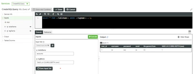

Hi all,
I have to run a query on MS SQL Database table, which has columns with spaces in their names (ex: 'SA03 LH CS BRG DEPTH (mm)').
How do I query this successfully?
Here is an example query:
SELECT *
FROM <<tableName>>
WHERE <<tagName>> != 0;
Here <<tagName>> is a column with space in its name.

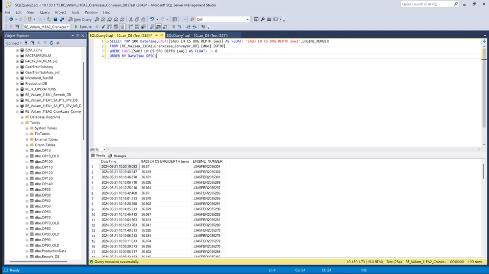

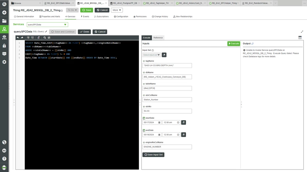

Hi @Arun_C ,
PFA screenshot, I have tried it on MS SQL it doesn't seem to be working.
Can you try it on MS SQL & let me know.

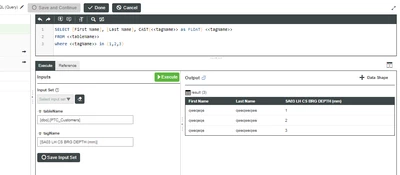

Arun_C16-PearlAnswer
May 21, 2024 7:00 AM UTC
Hi @PSB ,
I have tried in MS SQL DB. Kindly find the below atttached snapshot for your references.
