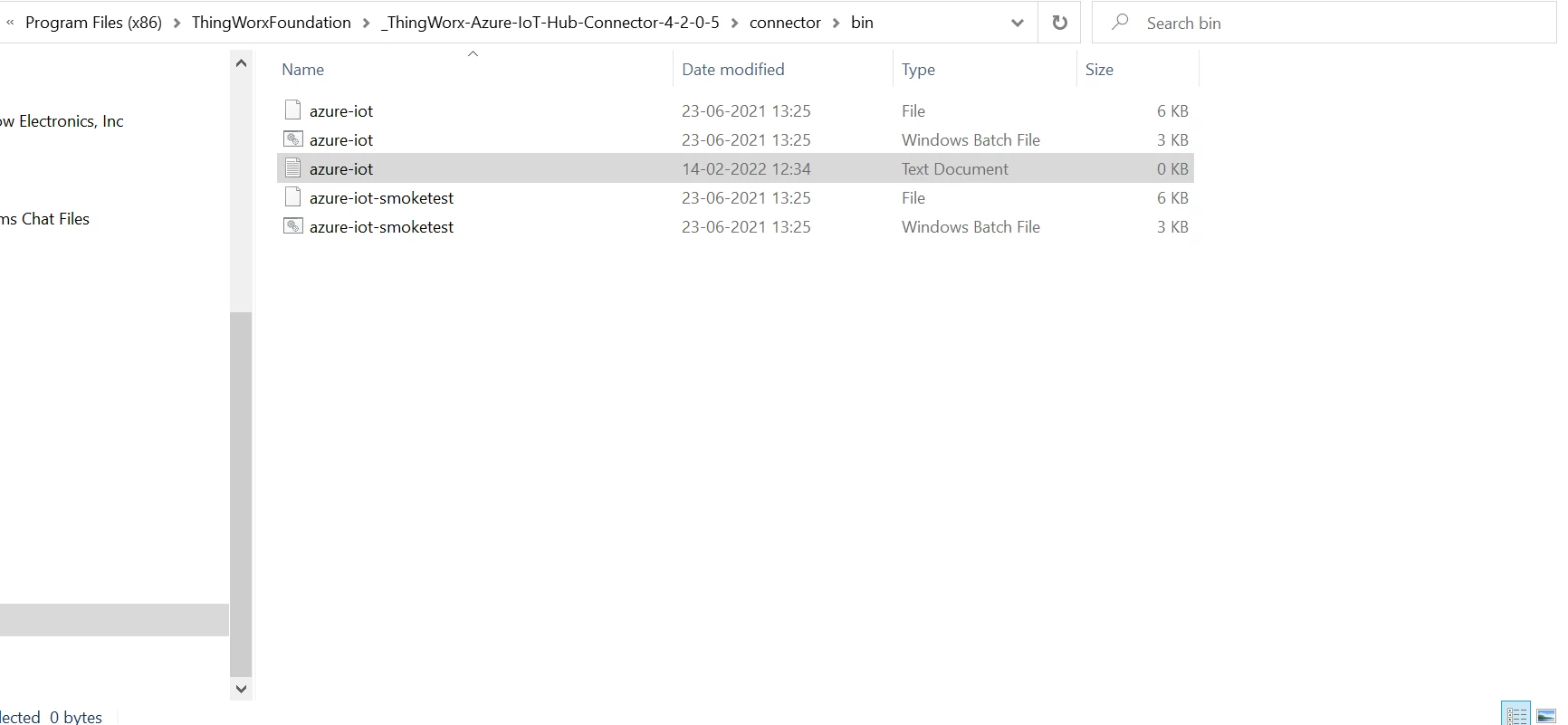

Thingworx to azure connecter issue

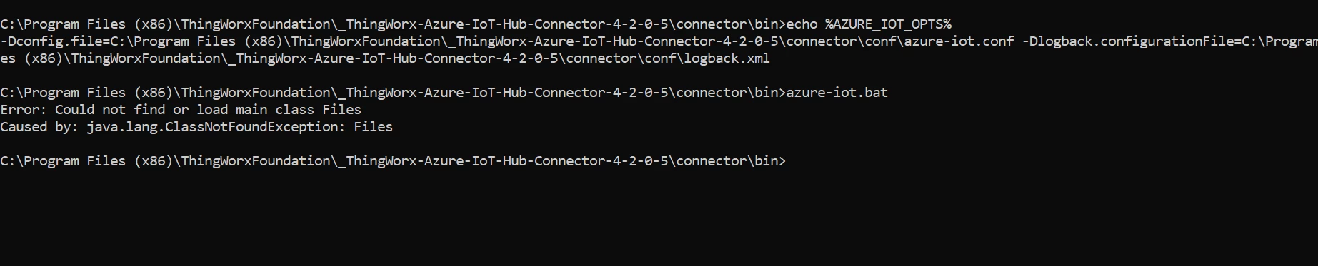

Error: Could not find or load main class Files
Caused by: java.lang.ClassNotFoundException: Files
Getting above while connecting thingworx to azure iot hub using thingworx connecter
Needed help related this Give solutions ASAP

Hi @VS_10112707.
This sounds like a configuration issue.  Have you followed the instructions in the Help Center for installation and configuration?  Be sure to validate system requirements.
If you still require assistance, we need to take a look at your configuration files.
