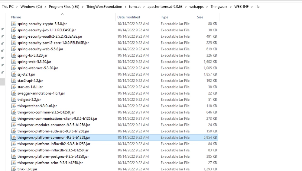

Hi @BharathB
Thanks for sharing logs, kindly check the below location and let me know the theworx-platform-common-9.3.5-b1258.jar jar file is found in your instance.
file:/C:/Program%20Files%20(x86)/ThingWorxFoundation/tomcat/current/webapps/Thingworx/WEB-INF/lib/thingworx-platform-common-9.3.5-b1258.jar)
BharathB12-AmethystAuthor
Hi @Surya_Tiwari
Yeah its there in the folder
