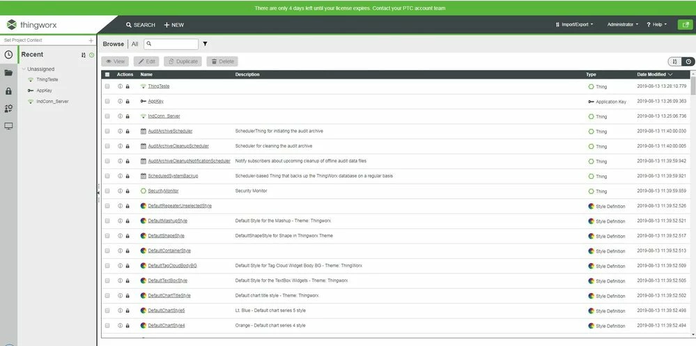

Hello @einsfele,
is this your 90 Days Trial TWX Server?
To see the current license details loaded on your server and the expiration dates, you can go to Subsystems > LicensingSubsystem > Services > run GetCurrentLicenseInfo.
Look at the column ExpirationDate, which dates are there? Is there any date that expires in 4 days? If yes, what is the feature (ProductName) for that one?
How are you licensing your TWX Server? Are you using any license_capability_response.bin or license.bin under /ThingworxPlatform? Or are you using the connected mode by entering the credentials to connect to our License Server in your platform-settings.json?
Please provide the details, don't post any of these files, as they might contain confidential data.

Hi @einsfele.
Are you still having an issue with the trial version that was installed?  If a previous version was installed, that is most likely the reason for the quick expiration.  You can reach out to the Sales team to discuss an extension or purchase licensing.
If the scenario is not the one described, please provide more details.
Regards.
--Sharon
einsfele1-VisitorAuthor
August 21, 2019
Hi @slangley
I belive was it.
Previously I had install the Trial Edition, but I do not used at moment.
Thanks for help me.
