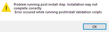

Hello everyone,
so I am trying to install the latest Thingworx Foundation trial. The downloaded trial only contains the twxFoundationH2Trial-8.3.2-windows-installer.exe file.
After having set a password and trying port 80 (and 8080) the installation fails after "Waiting for the Thingworx Platform".
Then the following Error Windows appear:
Attached you can find the installation log.
Any help is appreciated very much.

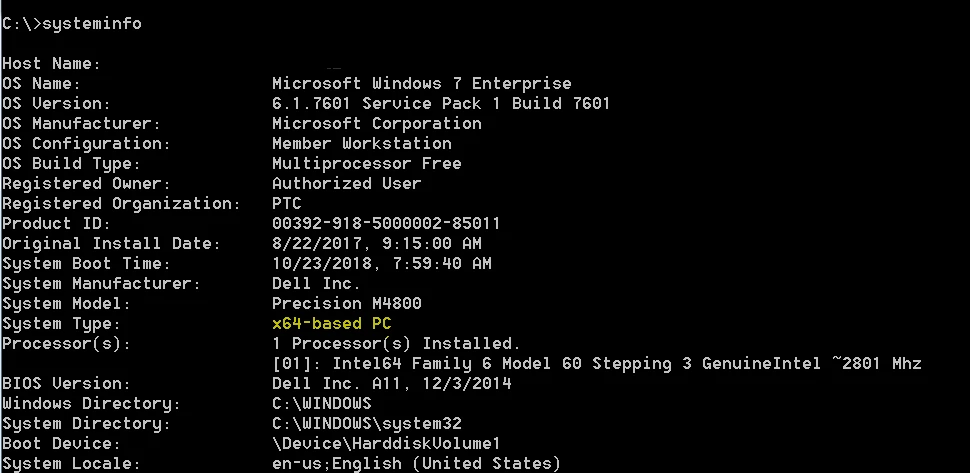

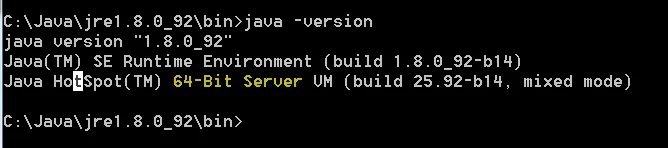

It probably won't work given you've made previous attempts.  However, before trying it on another machine, what o/s are you running?  Is it 64-bit?  Did you confirm you pointed the release to a supported 64-bit java version?
To check the o/s version, you can run the following command from the command prompt:  systeminfo
To validate that you are running a 64-bit java version, navigate to the java installation on your machine and run:  java -version

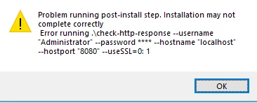

Hi @drieder.
Is it possible that you already have something listening on port 8080?  This is the default for Tomcat.  You can run the following command from the command prompt to see if the port is already in use:  netstat -ano
Or you can try changing to a different port, like 8989.
Note: Now that you have made previous attempts to run the installer for the trial version, it may not be possible to install.  The best thing to do is to try it.  If it continues to fail, you will need to either install it on a different machine or perform a clean install of the o/s on the existing machine to remove the hooks that are created when the installer is run.
