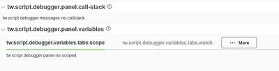

I'm experiencing an issue following a ThingWorx upgrade via the ThingWorx Foundation Installer for PostgreSQL. The labels for the newly added debugger feature are missing. Can anyone confirm if they're seeing the same problem?

Hi @ReetamKbanik ,
Can you perform an Empty Cache and Hard Reload (in Chrome) ?
Or clear all your History and try again.

Hi @ReetamKbanik ,
