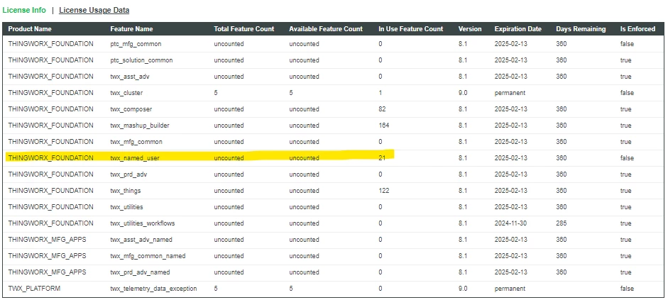

I have license for thingworx, how can i know how many users i can created in my thingworx? i already check the license subsytem setting and it said uncounted, Please explain it to me what uncounted means. Since i check on my detailed license report-data and it said the qty is 25. I tried to create 26 users and nothing happened.

Here uncounted meaning is unlimited users. You can create as many users as required.
Pls refer the following articles:
https://www.ptc.com/en/support/article/CS328492
https://www.ptc.com/en/support/article/CS290759
