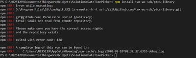

Hi @FredSilva92, seems like you are trying to get the codes from the remote repository. You should download the file first and install it locally via the command.
Check here for more details:
https://community.ptc.com/t5/ThingWorx-Developers/Thingworx-Web-Component-Development-Guidelines/m-p/681601#M47138

Hi @CharlesJi,
Thank you for our suggestion, i will try it.
