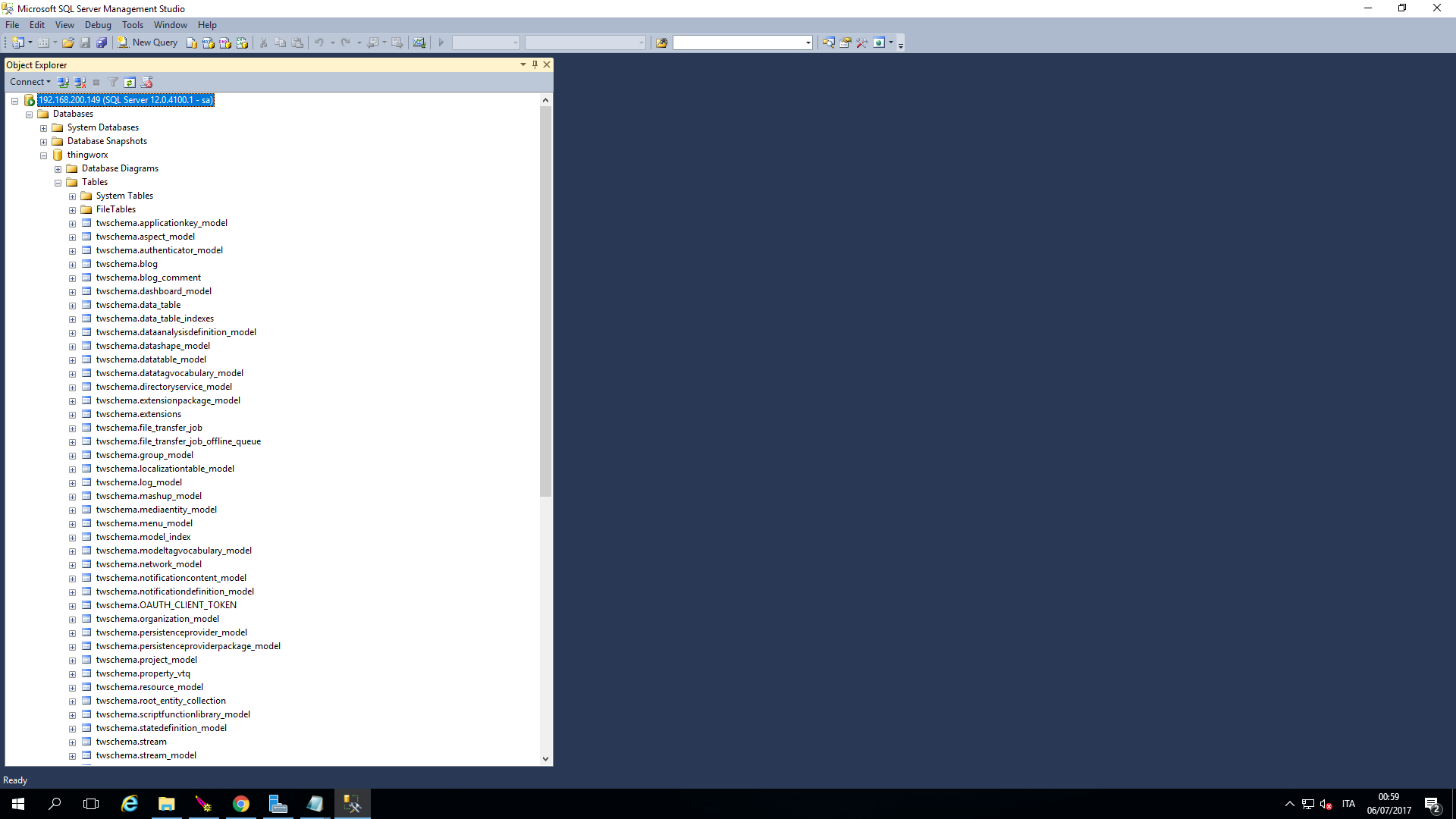

Hi everyone,
I'm installing thingworx 8 with MSQL. After deploy war, thingworx give me error below.
I configured properly the local Database:
My platform-settings:

In the tomcat I found this warn and errors:

Any suggestion?

    Try chaning your platform-settings.json to the following format (replace your password and username accordingly):
      "PersistenceProviderPackageConfigs": {
      "MssqlPersistenceProviderPackage": {
      "ConnectionInformation": {
         "driverClass": "com.microsoft.sqlserver.jdbc.SQLServerDriver",
      "jdbcUrl": "jdbc:sqlserver://localhost:1433;databaseName=thingworx;applicationName=Thingworx;",
      "password": "ts",
      "username": "twadmin"
    posipova20-TurquoiseAnswer

    I have a similar error, however, the MS SQL database is located on a different server (not locally).  How do you recommend the platform-settings.json setting to be configured ?
    Currently this is what I have:
                                    "jdbcUrl": "jdbc:sqlserver://SQL-server-01:1433;databaseName=thingworx;applicationName=Thingworx;",
                                    "password": "password",
                                    "username": "TWADMIN"
    April 20, 2018
    Can you replace the name SQL-server-01 with the IP, just to check if the name resolution works ok?
