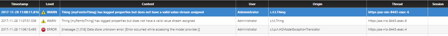

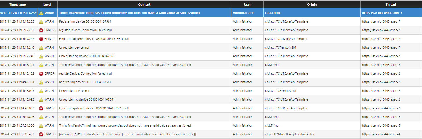

I'm trying connect one board with one temperature and humidity sensor to thingworx platform but I'm getting some warnings and errors. I attach one image with the logs.
EDIT: I already have my device connected but now it shows this:
Error setting Analog Property value: null
Thing [TesteSensor] has logged properties but does not have a valid value stream assigned

The error shown in logs is rather specific - there is no value stream assigned to your thing.

Dmitry Tsarev​ yes I know, but I imported some entities so I'm not totally inside the connections. I don't have any value stream created.
I just need to create one and associate to my thing? How do I associate some value stream to other thing?

Peter Giggs, see the attached video.
I'd also suggest you take a look at the Quick Guides (including the "Hello, World" one) available at developer.thingworx.com
