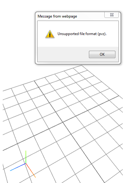

Hi All,
I would like to see in the Three Model Viewer the file from Creo (pvz format file).
Which extension should be loaded?
Many Thanks
BR
Dimitri

Nov 2, 2018 7:15 PM UTC
Hi there,
now you can import pvz files into 3d model viewer widget.
Version 1.4.310
kind regards,
Erik Schmidt / inray Industriesoftware
Support

Dec 3, 2018 2:27 AM UTC
FYI, besides the latest 3-Model viewer extension that you can get from other TS members, there's another widget that can show a pvz file.
There is an extension/widget called ThingView in Winchill extension package, and it can present the pvz file properly.  https://www.ptc.com/en/support/article?n=CS288755&posno=1&q=thingview&source=search
