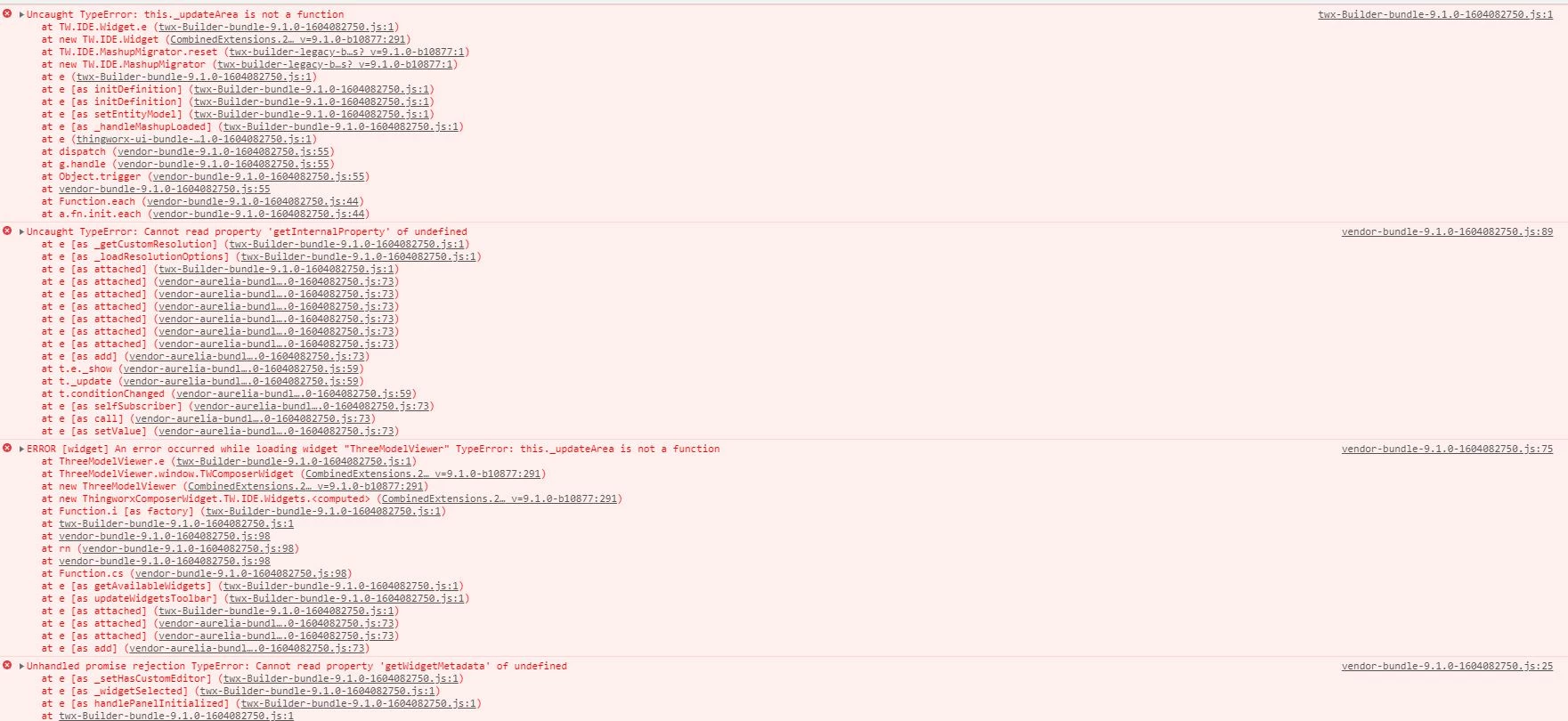

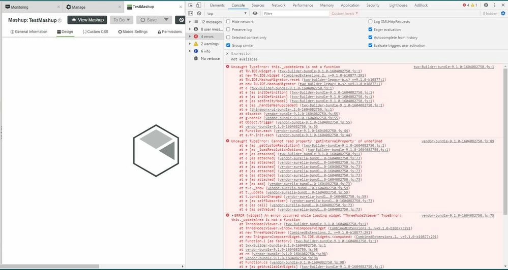

i am getting an error after importing the Three Model Viewer Extension from  https://github.com/ptc-iot-sharing  after updating to Thingworx 9. (https://github.com/ptc-iot-sharing/ThreeViewerWidgetTWX )
The error message is included in the attachment. The error occcurs on opening any mashup, so the designer is not even loading at all.
Are there any new properties or settings to apply to achieve compatibility in this TW Version? The validation check was fine.
Can anyone help me?

Hello @PF_9427478 ,
I am sorry I have got ahead of myself. After reading again your post I understand that you can import the extension without issues but you cannot view mashups. Is it possible to share the mashups that are not loading to try to reproduce the same ?

thanks for your quick response. I tried your first solution and it did actually work.
However, the version provided in ThreeModelViewer_ExtensionPackage_SRC.zip is already 4 years old and not up to date.
What i tried is to use the release Version and uploaded it. https://github.com/ptc-iot-sharing/ThreeViewerWidgetTWX/releases/tag/1.5.0
Once I upload the extension and refresh the page, any mashup is not loading anymore and I am stuck with the errors mentioned before.
Thanks in advance,
Patrick
Hello @PF_9427478 ,
Seems the extension has some issue.
This extension is from ThingWorx Lab, which is not supported by PTC.
There is another option from Windchill extension.
There is an extension/widget called ThingView in Winchill extension package, and it can present the pvz file properly. https://www.ptc.com/en/support/article?n=CS288755&posno=1&q=thingview&source=search
