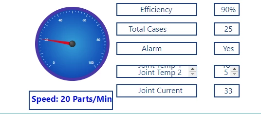

I have a query regarding how to add values to a scrollable panel so that every 10 seconds it should display the updated values corresponding to a label.
I will attach the screenshot for a better understanding of the query.

Hi Airin,
Could you provide more inputs on how you achieved the scrolling panel? From the image you have attached, it appears that you placed a label widget inside a panel. The scroll appears because the text assigned to the label inside the panel has grown out of the label and panel height. Please correct me if I am wrong.

Hi Rajesh,
Yes, your assumption is right.
For the time being, I placed a label inside the panel to give an idea how the entries should look like.
What I really want to achieve is, a dynamically changing name field and corresponding value field inside a scroll panel.
If that's possible, kindly help me with a solution.
