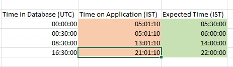

I am using MS SQL Server with Thingworx (AMU).
I have a table, in which I have start time column, which data type is time(0).
Once Start time shown on application, Thingworx is automatically converting UTC values to IST but there is approximately 58 min lagging and some other issues as well. Refer the attachment.
I tried changing time-zone to UTC of my local system, then time in application is 29 min behind.
Please let me know any work around for this.

Hello @mstarnaud ,
I used a workaround and issue is resolved now.
1.  While fetching the data (time), I added Date and type as datetimeoffset(7).
SELECT
DATEADD (day, DATEDIFF (day, 0, GETUTCDATE()), CONVERT datetimeoffset, (starttime) as starttine,
FROM dbo.tblName;
2. While displaying on the grid, used formatting as hh:mm:ss A
Now the value is being stored in UTC and displaying in IST on UI with correct values.
Thank you all, once again!

Thank you  @Surya_Tiwari  for the link, I have gone through it, in my case offset comes 0.
I do not have any issue with UTC and IST conversion, but the conversion is not correct.
Any other thought on it.

- In the AMU database, all time-typed columns should be in DATETIMEOFFSET, not in TIME(0).
- This leads me to ask : in what screen/Mashup do you see the values at the wrong time? An existing AMU screen, or a custom one that you made?
I must say I'm not familiar with TIME(0) and how reliable it converts the time in the Mashups. I would like you to go to one of the AMU screens, such as Operations -> Alarms, or Tools -> Troubleshooter, and check if the times listed there are correctly translated into your local time. This could help confirm if it's one of my 2 suspects (custom Mashup/service issue, datatype conversion issue) or if it's something else. Another test you could do is temporarily change your computer's timezone to something else, like Europe time, and see if that conversion works correctly or if there's still a 30m mismatch.

This issue is for a custom page.
I am creating a page to configure shift, and I want to store only time and not date, so I am using time(0) as datatype for column.
As mentioned earlier, when I tried changing time-zone to UTC of my local system, then time in application is 29 min behind.
At other places it is correct, however those are datetime and not only time.
