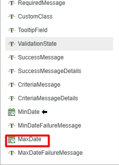

I want to restrict the User from choosing a future date. For example, today is 24-08-2023 1:00:00, and the User shouldn't be able to select 25-08-2023 1:00:00. All the future dates should be disabled for selection on the Runtime.
I have restricted the user from choosing the future date by giving the value to the Max Date but the user can select the time 2:00:00 from the widget in the Runtime. How can I limit it?

Hi @pshashipreetham.
Which version of ThingWorx are you using?
For something of this nature, I would recommend that we open a case.  One of our engineers working with R&D may be able to come up with a solution and if not, this can be considered as an enhancement for a future release.
I'll be happy to open the case on your behalf if you agree.

Hi @slangley ,
Thingworx Version: 9.3.4
Please go ahead and raise a case.

After Raising a Ticket with the PTC R&D Team we learned that this will get fixed in the Thingworx Version 9.3.6.

After Raising a Ticket with the PTC R&D Team, we learned that this will get fixed in the Thingworx Version 9..6.
