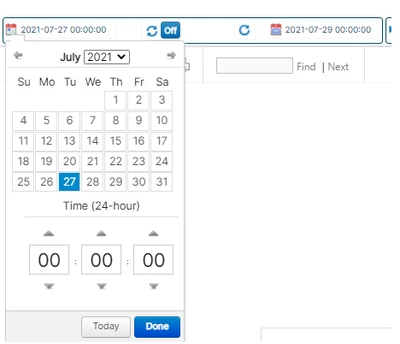

Time Selector Widget - Calendar Start of week
Is it possible to set Calendar (select date) to start weeks with Mondays instead of Sundays? Meaning the Sunday column below would shift to the far right.

Hi @nlindqvist ,
This is the design and cannot be changed.

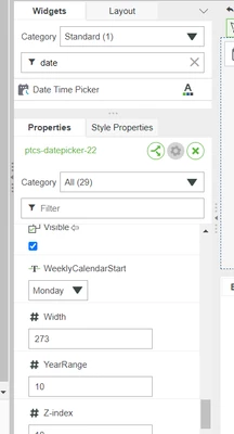

Hey @nlindqvist ,
I hope you are using Date Time Picker widget and in the property field of the widget a field is available by the name of WeeklyCalendarStart.
Set the value of this field as Monday.
Attaching the screenshot for your reference.
