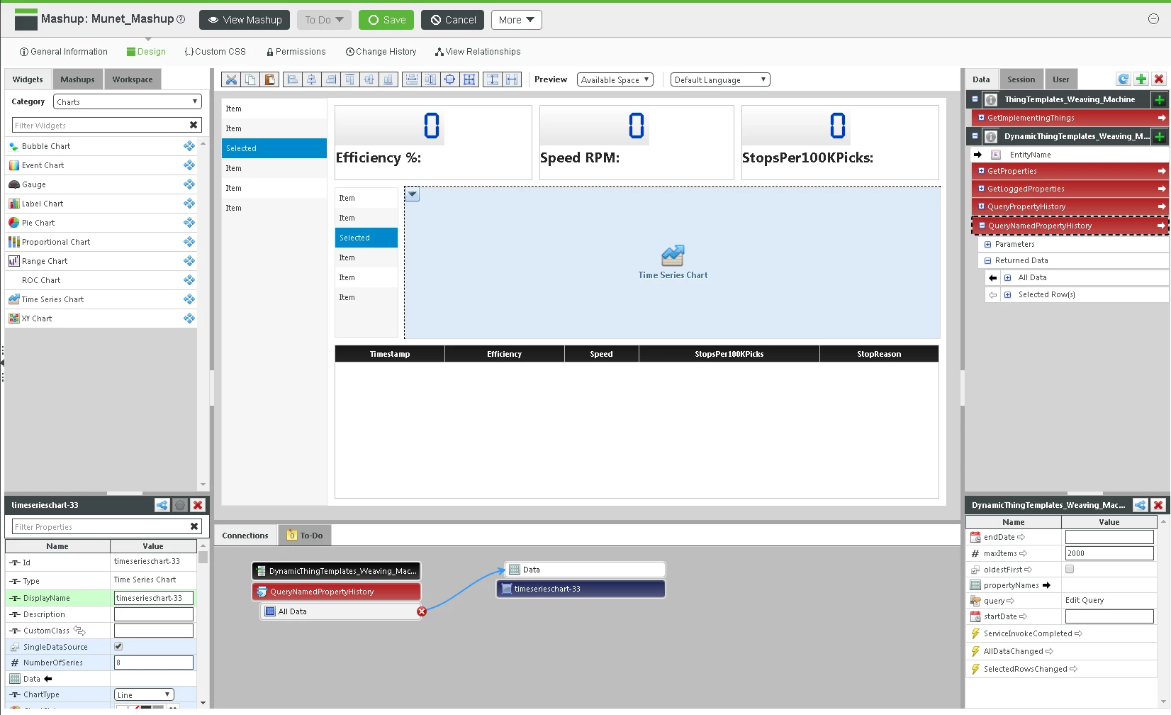

Thanks for the project @michaBrunner !
I imported it and it's only displaying the number.
It seems like for the Chart the Properties have not been bound - I'm not sure if that's due to the export or something missing in the original configuration.
Could you please map in the Chart's properties
  • XAxisField = timestamp
  • DataField1 = TestLong
  • DataField2 = TestNumber
This did the trick for me.
I hope it's working for you as well - if not, please let me know...
Cheers,
Michael

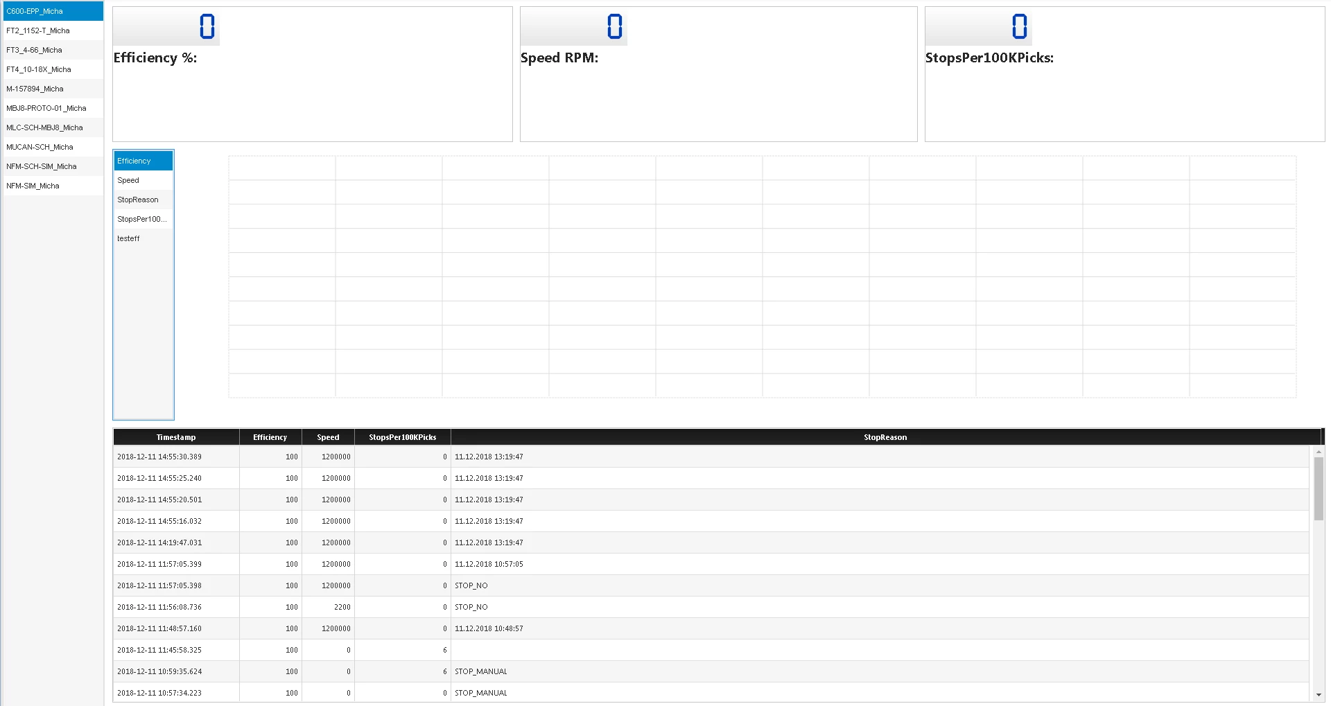

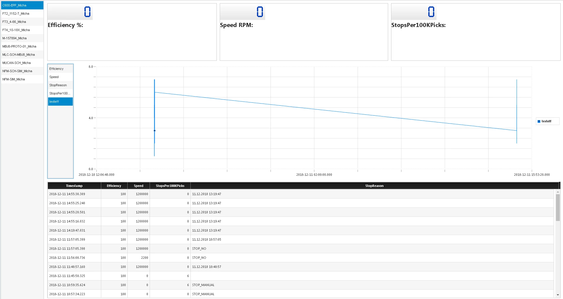

Hi Thanks for the reply
I am using ThingWorx 8.3.2-b535. This is strange...
I've attached 3 files of my mashup. I added an additional property to my C600-EPP_Micha Thing which is of Type Number and has the name "testeff". As you can see this property is displayed in the time series chart.
But when I select "Efficiency" which is of type LONG then nothing is displayed. The data seems to load as you can see in the table below the chart. There are a lot of values for Efficiency, Speed and StopsPer100KPicks which are all properties of type LONG. So the query itself must be working.
The 3rd screenshot is showing the configuration of the table. Do you have any Idea how this could happen?
I did the same with a generic thing, which has two properties one is a LONG and one is NUMBER. The NUMBER one is displayed, the Long one not.
