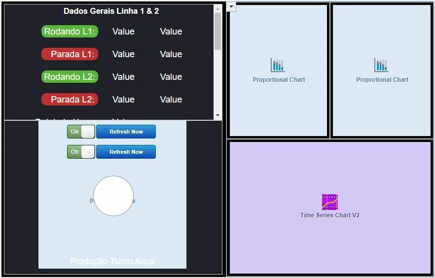

Hi everyone,
My environment:
Thingworx 8.5
I'm using the Time Series Chart V2 - Custom Chart 3.0.3 from Marketplace.
This is my designe from composer:
This is my runtime:
They are able to observe that the Time Series Chart Widget does not obeying the responsiveness.
**All my containers are responsives.
Is there any code CSS that I can put to do this?
Leonardo

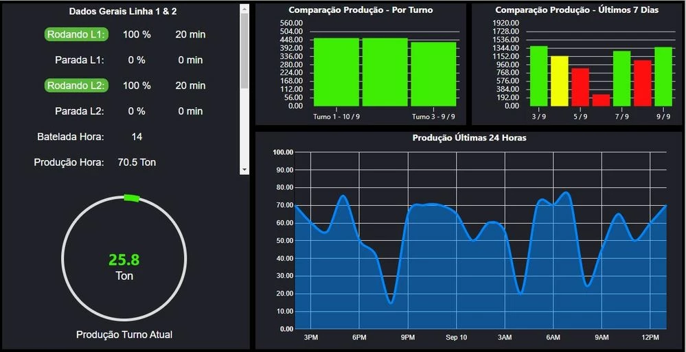

Sep 15, 2020 4:12 AM UTC
The chart widget is always response, you can see a four-arrow icon after the widget. Only if the background panel is in fixed size, will the chart become not responsive.
To check this, you can edit the mashup, remove this Chart widget, and see if there show up a four-Arrow image in the back where the widget is placed.

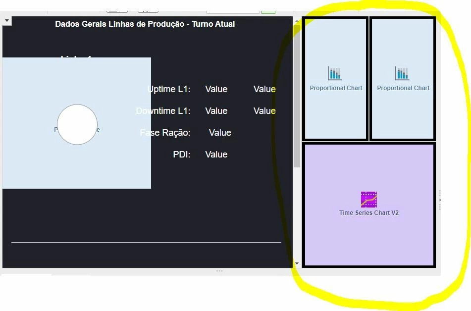

Sep 15, 2020 12:22 PM UTC
Hi @zyuan1 @emoreira
Thanks for your answer.
I checked all the containers and it is responsive.

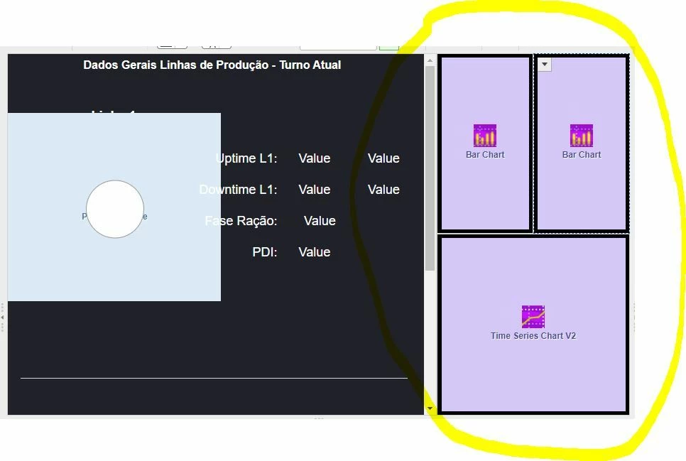

I was able to realize that when I use the chart from the same family (pink + pink), for example, custom chart, it work well. Image below:
The problem happens when, for example, I use different charts (blue + pink). Image below:

Oct 9, 2020 7:29 AM UTC
It looked alright in this picture, can't tell how charts in above would affect the timeseries chart.  If it's really the case, you can create a case to report bug.
