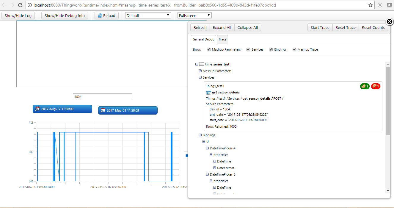

I have a service that return data with fields
1-time
2-status (some numeric value)
3- id
as shown in the attachment

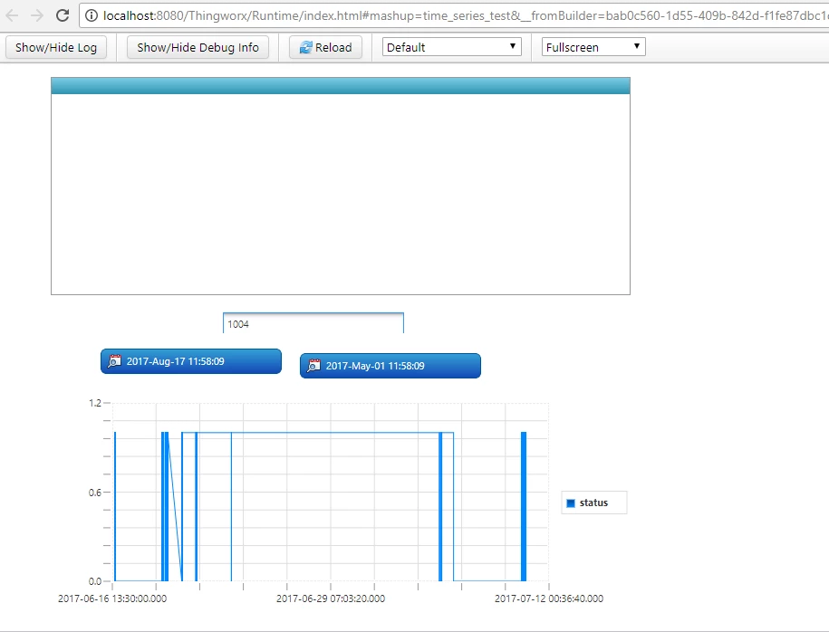

the result of the service is represented by time series chart default
but the time series chart v2 is blank
both the charts are binded with the same service
any help?
I am not able to figure why its is not showing the data
I have set the x axis field and data field

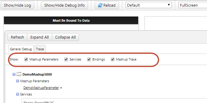

Hi Jugal, could you enable the Show Debug tool when you view the Mashup and check for the services and the bindings, make sure to enable the parameters
Alternatively you can also check via the Chrome's Developer Tool to see if it's showing any error to quickly highlight the issues

This is the debug data of my mashup
I have never used it previously so don't understand it much
Aug 17, 2017 9:11 AM UTC

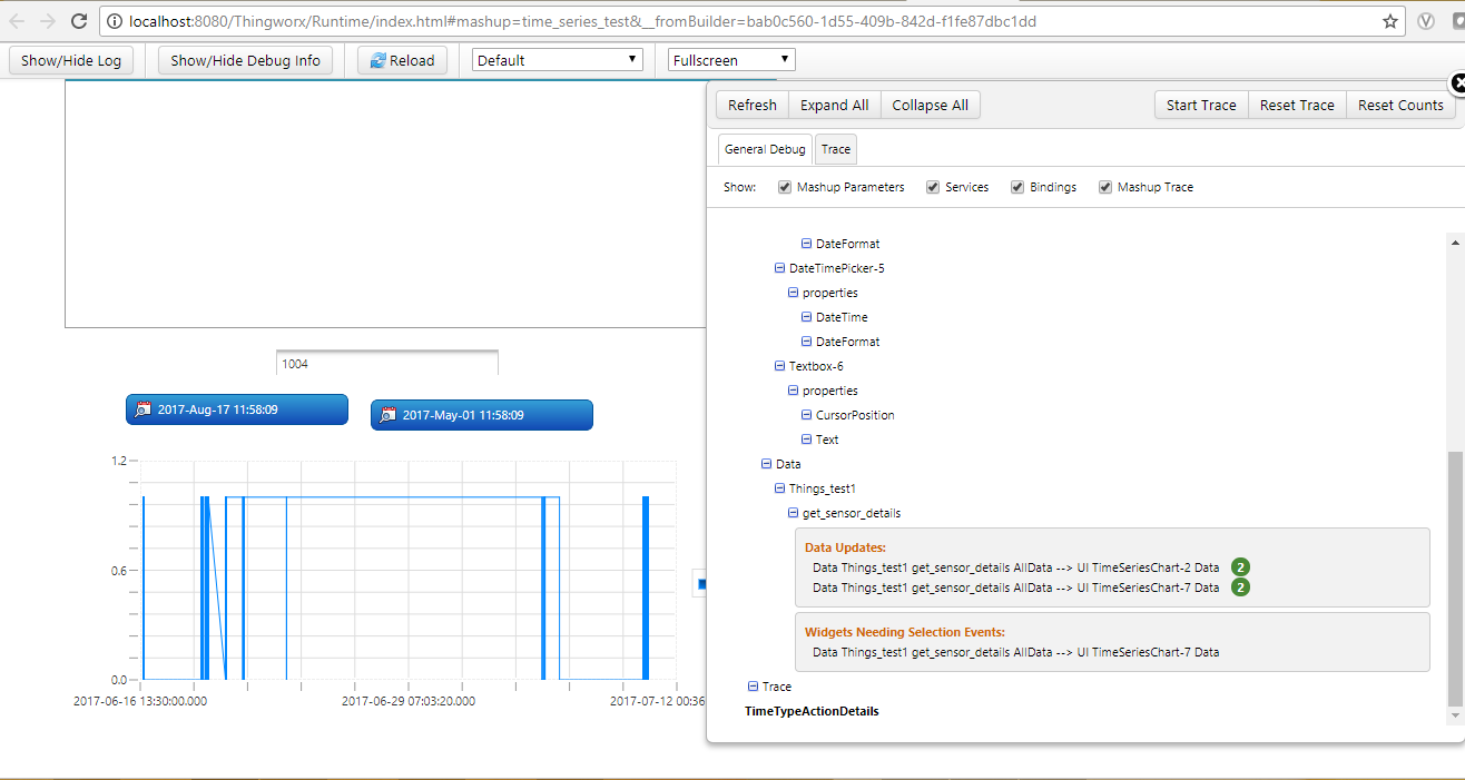

Jugal, as you can see the service works fine for one as you get that green thumbs up and same service shows thumbs down in red, did you check the ApplicationLog or the browser's developer console for more specific detail?
jshah-31-VisitorAuthor
Aug 18, 2017 7:56 AM UTC
[context: com.thingworx.webservices.context.HttpExecutionContext@16479d39][message: Unable To Parse JSON Request]
this is logged in the application log
when I searched the error on internet
it shows number of digits is greater that 20 for number type
but as I ran the service no such number is big
Aug 18, 2017 10:47 AM UTC
Jugal, could also check the scriptLog, this error could happen for variety of reasons may be the Datashape you have assigned to the output for your service is not conducive to what is expected by the TimeSeries Chart v2, in case you don't see more information in script log either, you can enable the stack tracing on your service by navigating to the System > Subsystems > Logging Subsystem > Configuration and then enable the the Stack trace save the configuration and reload the mashup. Then disable the stack tracing and check for the ApplicationLog, ScriptLog and ErrorLog (stack trace is logged in ErrorLog.)
