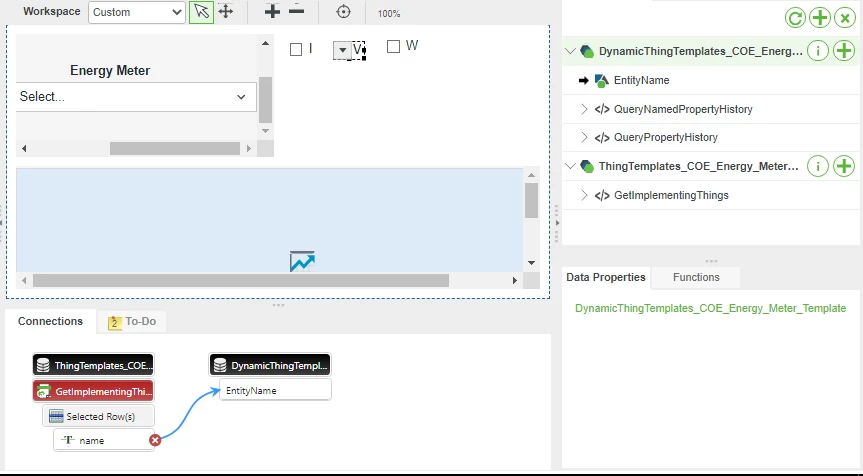

I need to display the values of current, voltage and power in time series chart based on the check box selection. How to do this?.
i) If I select Current, only Current values will be displayed in time series chart.
ii) If I select Current and Voltage, both the values should be displayed in time series chart.
iii) If I select Current, Voltage and power all the values should be displayed in time series chart.
iv) If I deselect any one it should not be displayed in the chart.
I have designed up to this and stuck after this,

As far as I understood you managed to get the dynamic thing, but you need to implement the service that is showing the data in the chart.
For that you need to do a service that has 3 inputs: Current, Voltage and Power. These are actually values taken from the checkboxes, either true or false.
In the service you check the values: if Current is true and the others are false, you will get only data for current,
else if Current and Voltage are true and Power false - get data only for Current and Voltage
else if all values are true - get data for all 3 values.
The result will be only one, an infotable (probably the datashape should be assigned from the service itself, if it is different for the 3 cases).
After this, just do the bindings: Changed event will trigger your new service.
Probably, there are other ways to do the implementation, but this is what came into my mind.
Hope it helps,
Raluca Edu

Sruthi15-MoonstoneAuthor
March 26, 2020
Thanks for the reply. It worked.
