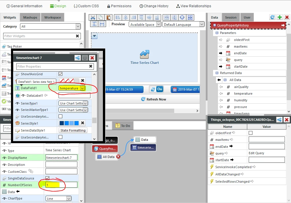

I have the folloing situation:
- I've installed some sensors, sending temperature, pressure and humidity.
- I made a mashup, showing the temperature in time series charts.
- Everything worked fine.
Now we added airQuality to the sensors to send. So I added this field to the thingTemplate, my sensorThings inherit from - updated my service to write this as well. Everything looked working fine.
Now the issue:

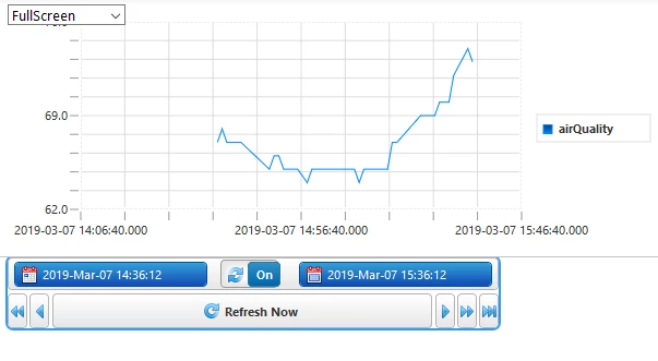

All my time series chars now show the airQuality value, insatead of temperature.
Even when creating a new mashup, setting it up and make one field to temperature... shows airQuality instead.
And it is not a refresh problem from my browser. I can set the DataLabel1 to something - and it will appear... but still show wrong data.
Can someone help me please!!

I already tried
- I also tested from another machine, that was not yet connected to thingworx.
- And I restarted my thingworx server even.
- Created a totally new mashup, with new time series chart.
- Only the "LED Display" shows right data.
This is currently really an issue, as all my collected data became worthless now.
EDIT:
I've deleted the airQuality field. And everything worked again. I've then "re"added a quality-field.
Now, all my charts can only again show temperature...not quality, not pressure or humidity. Everything and everywhere I see temperature...
