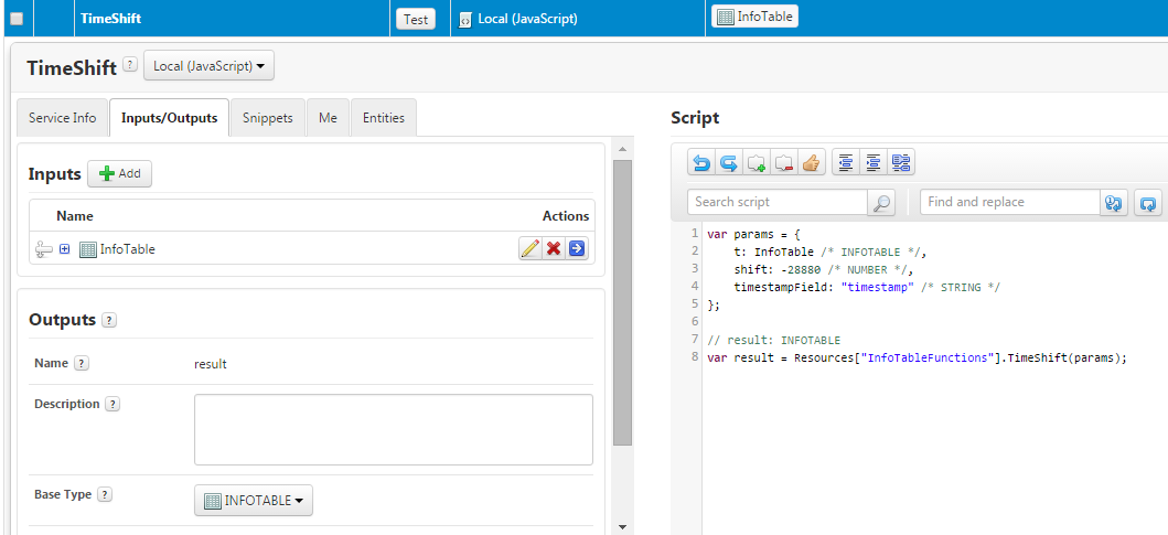

There is the capability to do a timeshift (Resources["InfoTableFunctions"].TimeShift(params); ) and you define the shift value.
Nov 12, 2015 5:31 AM UTC

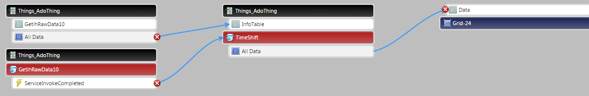

Just an update, I came across this problem also and think maybe I can share my solution here.
Keri is right, just use the timeshift function. You can just create a timeshift service with InfoTable as input. For this example, I set my Shift=-28900(- 8 hours).
Then, link the (All data) of the original service(lets say GetihRawData10) to the input(Infotable) of the timeshift service. Please take note that the datashape should be the same.
Then Drag the "ServiceCompletedCompleted" from the GetihRawData10 to the timeshift service.
Finally, drag the "All Data" from the timeshift service to a grid or chart to display the data.
You should see the timestamp values being offset by -8hours.
