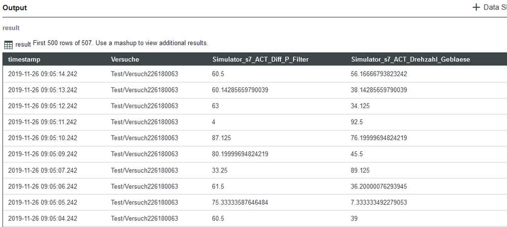

I am using Thingworx 8.4 with Postgres database, Analytics extension and Kepserverex. Thingworx and Kepserverex servers are configured to Timezone CET.
In the following examples the current time is ~1210(German Standard CET):
(1) I execute the queryPropertyHistory service with a Thing receiving data(current) from Kepserver, with the following results:
The time is exactly 3h off.

When I try to display the data in a Time Series chart in a mashup using QueryPropertyHistory, the time is 1h off.
The first (1) example changes the difference of time sometimes.
Also: I checked with different things, but got the same result.
What is the reason for this?
Best answer by raluca_edu
Check this article: https://www.ptc.com/en/support/article?n=CS315667
You need to update joda java library.
Thank you,
Raluca Edu
