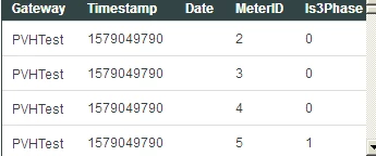

What I am trying to do here is getting the Timestamp values from the CSV file and I want them to be converted into DATETIME(for which you have given the snippet). I am stuck at a point where I want to convert the entire Timestamp column and the result should be in the same Infotable with Date column and Basetype already initialised in the Datashape
Attached is a screenshot of the service result. I want the DATETIME result to be populated there itself
iguerra16-PearlAnswer
April 8, 2020
Try looping your result infotable, and for each row assign the new date with this logic
ConvertedDate = new Date(unix_timesamp * 1000);
