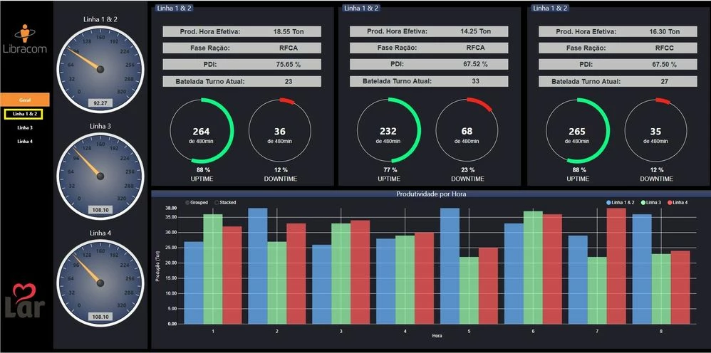

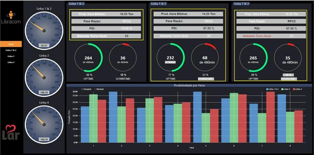

Hello everyone,
I have a problem navigating between my menu options
When I run my dashboard runtime it works fine, but when I browse my menu, when I return to the dashboard some formatting ends up changing. Below images:
Can anyone help me with this?
Best answer by leokeinsfeld
Hi @slangley
To resolve the issue I nedeed to change some property of label (for exampre: color or size) and after it to return to property that I wanted.
I do not know the why it happened but it was the only way that I found to resolve.
Thanks for your attention.
Regards.

Hi @leokeinsfeld.
Try testing it under different browsers to see if the same issue occurs.  If it's consistent across browsers, please provide your ThingWorx version (including patch level), so we can test it on our end.

leokeinsfeld1-VisitorAuthorAnswer
June 11, 2020
Hi @slangley
Regards.
