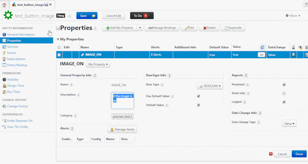

1.) create a thing /general thing with one boolen property e.g. IMAGE_ON:

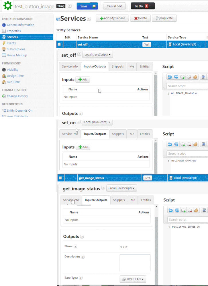

2.) defined 3 services
set_on                        - set the value of the property IMAGE_ON to true
set_off                        - set the value of the property IMAGE_ON to false
get_image_status  -returns the property value of  IMAGE_ON

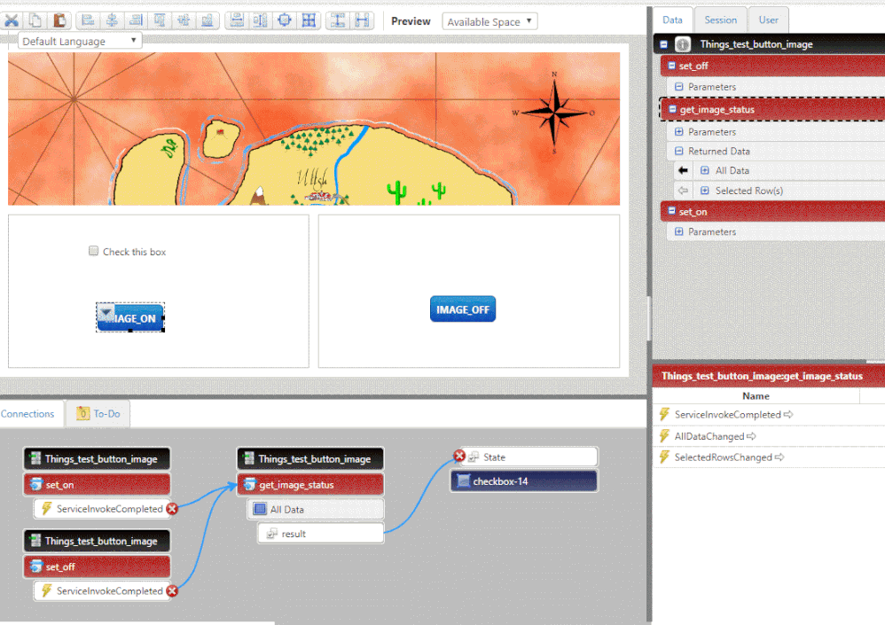

3.) create a mashupe with 2 button for set_on and set_off and a  image
4.) bind the all data result of the service get_image_status to the visible property of image (here I used not the directl way where I set the state of a checkbox and later the checkbox has the binding to the visible property of the image)
5.) bind the buttons image_on/image_off  clicked event to the services set_on/set_off
6.) bind services set_on/set_off  ServiceInvokeCompleted  event to call the get_image_status. service.

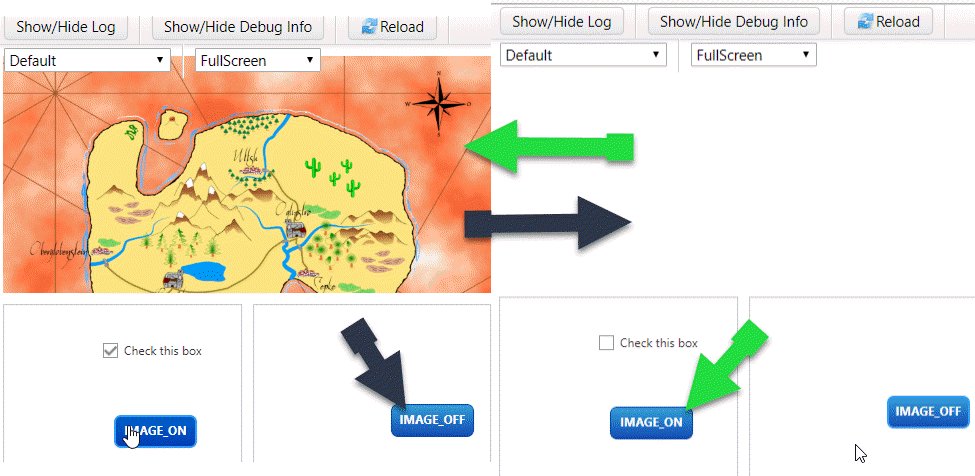

Here we can see the steps in the picture below:
7.)I  tested it in mashup preview mode:
