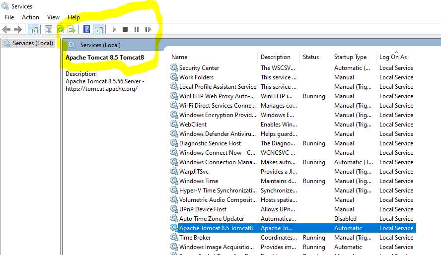

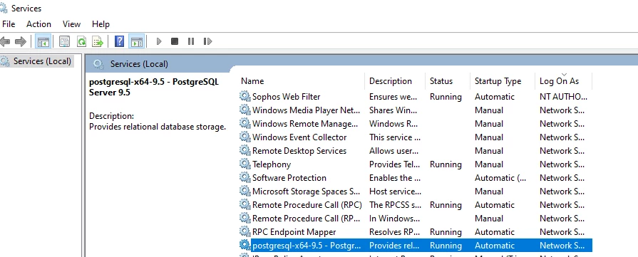

Hi, Tomcat8.5 and PostgerSQL 9.5.22and Thingworx PostgreSQl 8-4-10, refer installation Document is PTC Thingworx Installtion Guide 8.4. in windows10 i couldn't seen in restart or stop or start option for services app.. doing installtion step do restart Tomcat and do restart PostgerSQL that time ,i couldn't do this step.. so pls consider me ..and reply sir.

  1. Do these option appear if you right click the service?
  2. Does your Windows user have Administrator privileges?
  3. What happens if you start your Services app using "Run as Administrator" option?
  4. You could also try stopping & starting these services from command prompt using either
net stop <service name>  and net start <service name>
or
sc stop <service name> and sc start <service name>

Hi all,
In Tomcat8.5.23 server running time,
i could use NET Stop Tomcat8 is working...After that I could Start NET start Tomact8 is Not work ..
in this condition i could n't restart Tomcat server...
any other method Is there..
please consider me.sir
