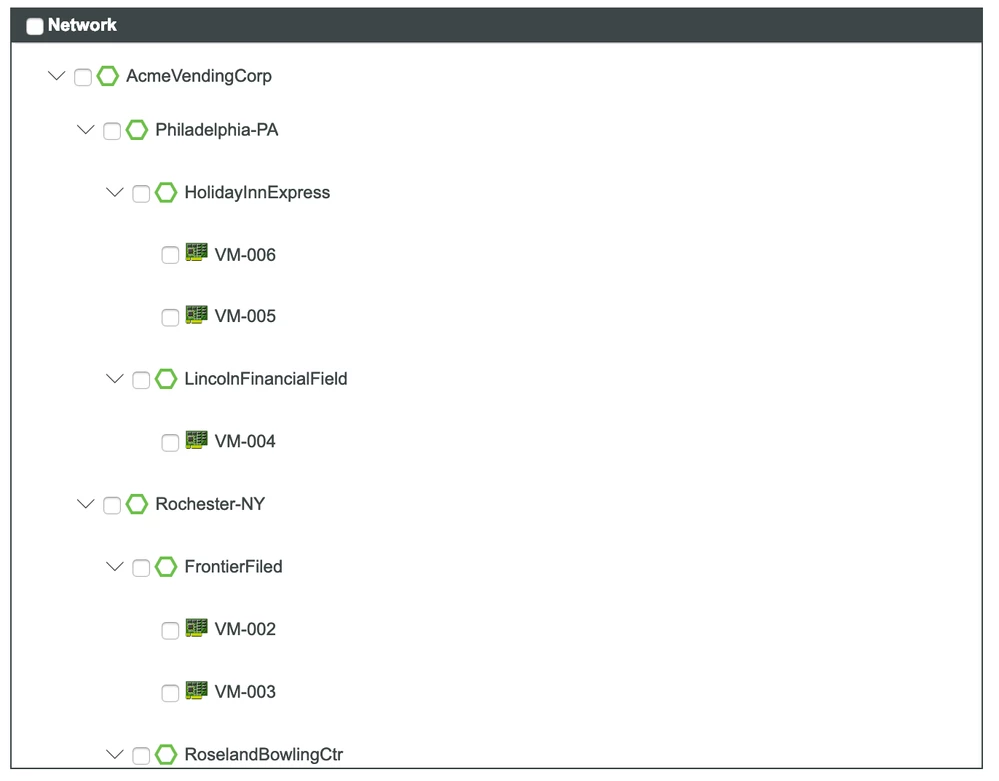

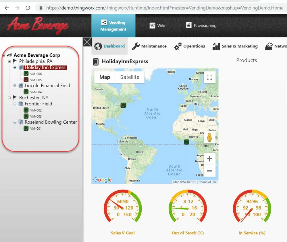

How to create the Tree chart menu in Thingworx as the above picture .
Last week ,I found the a exercise in the TW developer website for this one  .
But Unfortunately, TW developer website was update last weekend and this exercise is disappear .
Do you have any tutorial or document or the links for this one ?
Best answer by thingw0rxgenie
In order to create something like this, you'll need to create a Network and create a service that has JavaScript similar to the below functionality.

March 27, 2019
Here's link to realize the tree menu https://www.ptc.com/en/support/article?n=CS251574&posno=6&q=tree%20menu&source=search, but it does not include adding a image in front of each title.
March 27, 2019
The developer.thingworx.com website has a couple of guides showing how to link a selection on a side panel to the information shown in the main part of the website, but does not cover all the steps required to create the mashup:
https://developer.thingworx.com/en/resources/guides/customizable-responsive-ui/master-menu-create-menu
