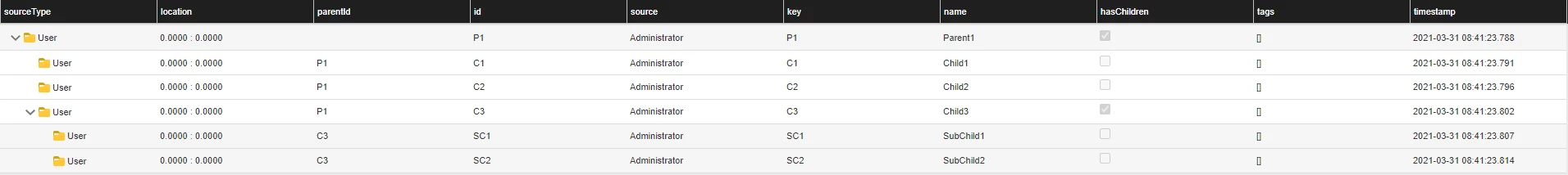

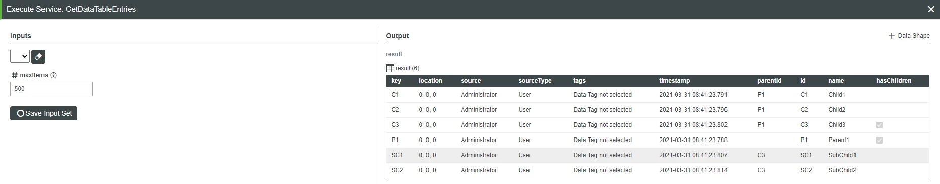

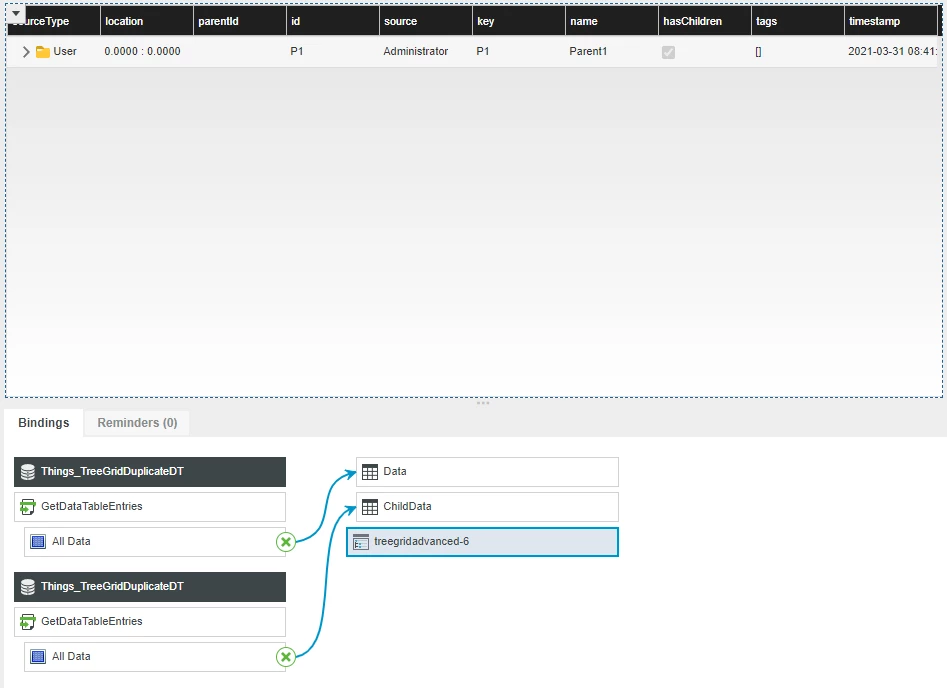

Regarding your service I am really not sure why it is not showing the child data in your mashup. If the content of your DataTable looks something like what is shown in the attached screenshot you should be able to display your data at runtime. I am also attaching the entities in case they can help. Also note that there is an example set of entities available under
Advanced Grids Samples File that can help with Working with Tree Grid Data.
