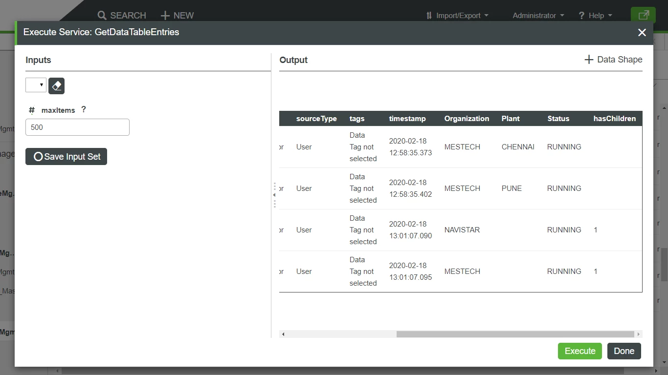

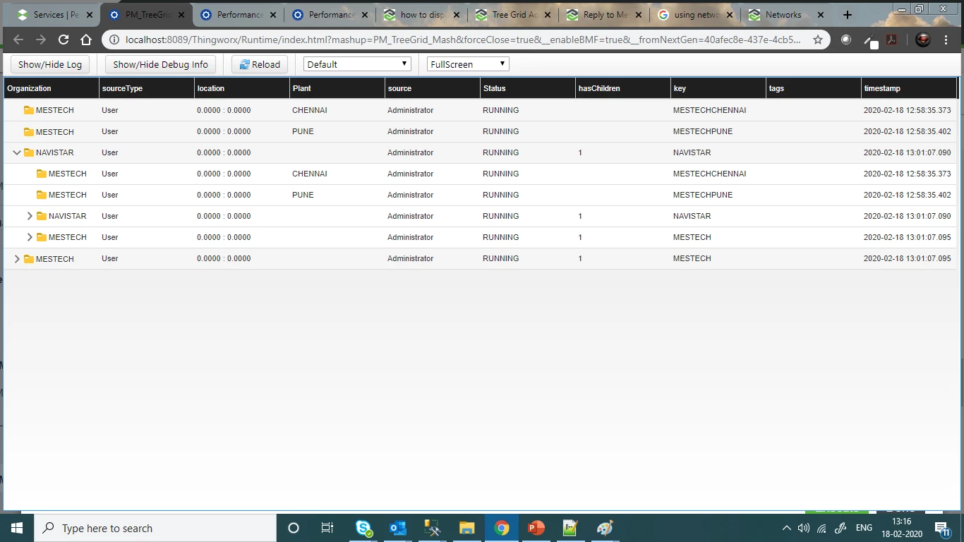

Hi @raluca_edu ,
I tried to fetch a data table like the attached screenshot, but its not giving me the expected result. In the image I am trying to fetch ORGANIZATION (parent) AND ITS RESPECTIVE PLANT(child). When I bind the getDatatableEntries, its not getting segregated according to the parent. Instead, it keeps repeating the whole data again as child.
Please tell me what I am missing.
Thanks in advance.
