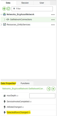

Tree Widget - Missing bindable events
The widget has no bindable events for selected items to trigger navigation to other mashups. There is only the double clicked event. Why is there no Clicked event, or selected row changed event?
May 27, 2025 10:26 AM UTC
You can use from "SelectedRowsChanged" event from Tree Data service
