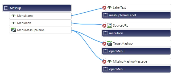

Here is the situation:
  • I'm using a collection widget which displays a group of mashups for the user to select between (collection because different users will have different options)
  • The repeated mashup in the collection contains the mashup name (in text) and a button to "navigate" to that mashup. This button triggers a Navigation function on the contained mashup.
  • The contained mashup has a mashup parameter for the Mashup Name to navigate to, and I've bound that parameter to the "TargetMashup" property in the navigation function.
  • Clicking the button in the contained mashup of the collection is not sending me to the navigated page.
What I've checked so far:
  • Mashup trace is showing the Navigation function as "ServiceInvoked" but it is never completed. (screenshot attached showing the only two lines in mashup trace after clicking the button to navigate)
  • I've bound the Mashup Name mashup parameter to the "MissingMashupMessage" property of the Navigation function, and the mashup name appears in the message, so I know the parameter is there, and is being bound to the Navigation function - it just isn't being recognized as the TargetMashup. (the screenshot attached shows the bindings to both properties, but removing it from the missingmashupmessage does not effect the result...)
  • Yes, the mashup names being passed match EXACTLY to existing mashups.
Is this a defect/bug? Am I missing a step? Any and all help is appreciated!

Feb 26, 2020 10:32 PM UTC
Hi Eric,
This may not be ideal, but have you considered using the link widget instead?
Perhaps you can add a 'mashupURL' parameter to your contained mashup, and bind it to the link widget's LinkURL property. You can then hide this widget, and then bind the click event of your button to the Navigate service of the link widget. I have a feeling that this might be a good workaround.
Let me know if you are able to get it to work!
Andrew

eribbeck1-VisitorAuthor
Feb 26, 2020 10:35 PM UTC
Thanks, Andrew - this is a good workaround. The link widget is working to do the same.
Would still love if the "TargetMashup" property worked on the Navigation function...

Mar 10, 2020 1:25 PM UTC
Hi @azoorob3 @eribbeck.
Bindings to TargetMashup and TargetMashupType parameters not being applied, is a bug that will be addressed in ThingWorx 8.5.5.   This version is targeted for release within the next several weeks.
Regards.
