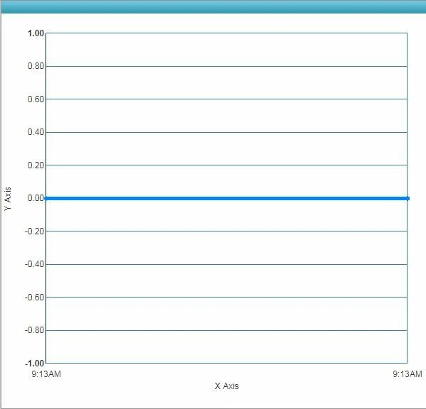

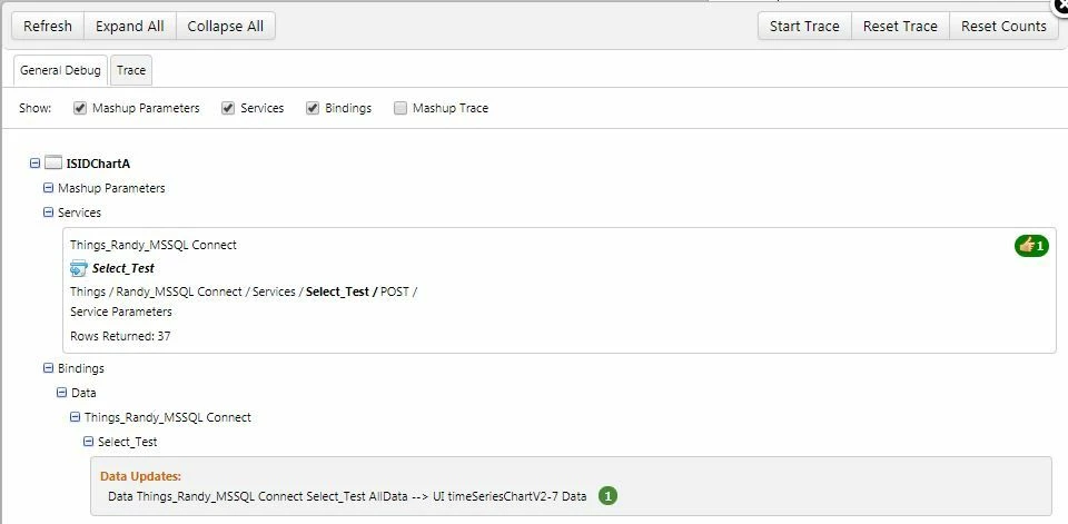

I am new to TWX and I am trying to create a simple mashup one time series chart.
At "View mashup", I am getting a blank chart, but "Debug Info" shows that I  have several rows returned.
What am I doing wrong?

Hi @RandyGui may be this is an issue with the DataShape which is being used in the service's output. While it is correct that your service is working fine by returning x number of rows, however what should be checked here is that what DataShape is assigned to the output and what has been selected for the X & Y axis properties for the Time Series chart. See Time Series Chart Widget property details here

Hi Supandey
It seems that I made a mistake with data column name and it's alias name.
chart's working fine now.
