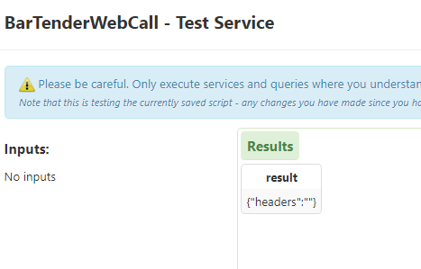

I am making an REST call from a service back to the ThingWorx platform that is running the service.  The purpose of this service it to programmatically create a subscription (I am aware of the Dynamic Subscription services, but they do not work for my use case).  If I make the REST call from the subscription everything works, but the response I get from the REST call doesn't tell me anything.  This isn't really useful in the case there is an error.

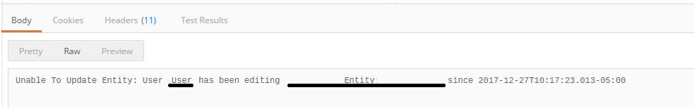

How can I get the same response in my script that the Application Log and POSTMAN are getting (see below)?
Example (names cleared out):
Response from service test:

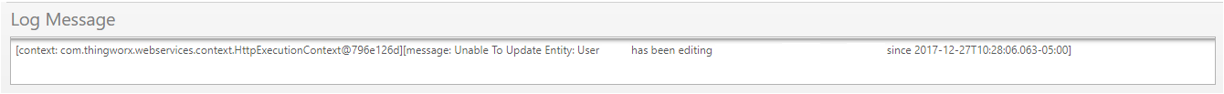

However, there was an error logged in the Application Log:
When I make the REST call from POSTMAN, it returns the same message as the Application Log:

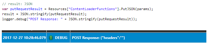

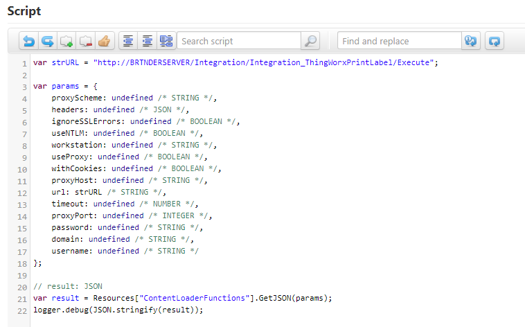

Here is the script and the message that is logged in the Script Log:

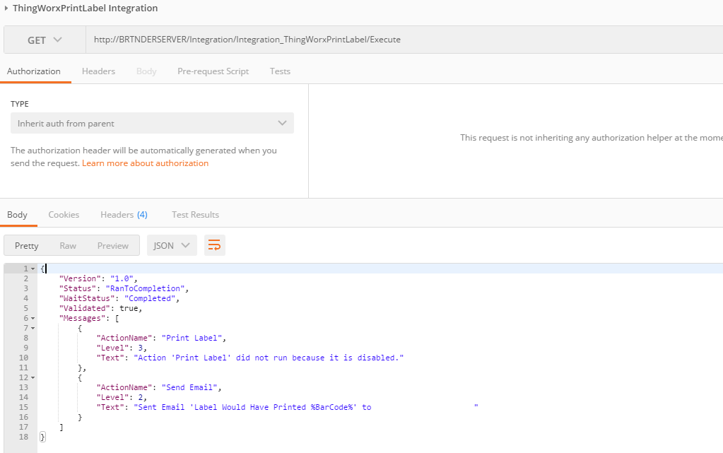

On another note, we are having the same issue when making REST calls to a BarTender print service.  The call is working and the labels are printing the but the content of the response is just  "{"headers":""}".  The response in BarTendder has much more data.  We'd like to have this response available in the service so we can display on a mashup why a print job failed.  Any ideas why this works in Postman, but not in ThingWorx?
TW Response and javascript:
Postman Response:
