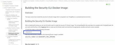

Hi @VladimirRosu_116627, I'm trying to create the security image but as you can see, in the documentation there is an impossible command shell, without param.
I didn't find the meaning going through the sh code.
maybe I missed something

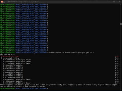

January 2, 2023
The error message in your second screenshot gives me the impression that you do not have permission to access the docker images.
Are the images located locally on your computer or are you trying to pull them from a remote registry?

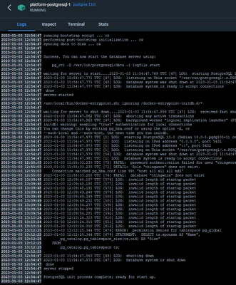

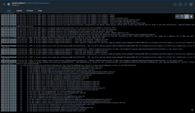

January 3, 2023
It is a bit hard to tell. But it looks like you are getting an error in your Postgres logs, although it does also say the initialization was completed...
For you platform it does look like there is something wrong with your security-cli. Might be because of the password.
I have attached my yaml file, I was using a MSSQL DB, but I hope you can still compare it to yours.
I know I had some issues with the security stuff as well and I think it was because I was missing something in the yaml file relating to the KEYSTORE.
Hope it helps you.
