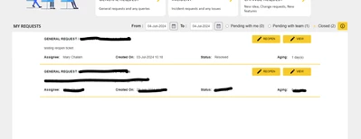

Trying to refresh mashup

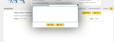

The above general request grid is populated using a collection widget... now when clicked on
reopen button, a pop-up window will opened like below.
On close of this pop-up window I would like to
refresh the grid.
I tried by binding the "windowClosed" event of the navigate function to refresh mashup in the collection widget mashup but the grid is not getting refreshed.....

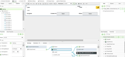

6-Contributor
Jul 4, 2024 1:15 PM UTC
Lets say in mashup "A"  a collection widget is used, another mashup (let say mashup "B" : child mashup)  is used to populate the cells in the collection widget.
In mashup "B" we have a navigation function that allows for the window pop-up on button click. On closing the window pop-up I'm trying to refresh mashup "B" using window closed event but that's not working, I'm assuming its not working because its the collection widget child mashup.... I need help to re-populate the collection cells to show the latest data.
