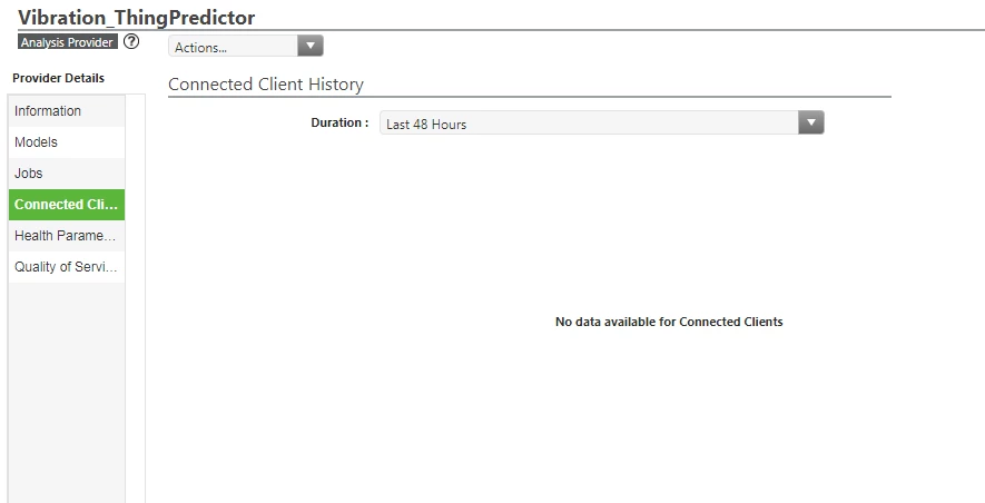

Hi, I am using offical thingworx to follow the beginner tutorial-Build and Deploy an Analytics Model.
In step 2, in tutorial, after click the connected clients, the chart with green square should be seen.
But in my exercise, I could not see the chart and it shows no data available (refer attachment).
IWOAnswer
i had the same problem....
The Analytics-Server-Settings changed to "use SSL".
After unchecking these Setting everthink works fine.
In the "new Composer" you can find this setting under "Analytics-Builder" -> "Settings".
I will attach a screenshot...

Another error when using analytics builder
Status Messages
Creating copy of Configuration File...
Creating copy of Data File...
Submitting Create Dataset request...
Dataset Create Job with jobId: 94c573b8-7b98-4009-ab02-3083bfb30b03 in progress...
Dataset Create Job with jobId: 94c573b8-7b98-4009-ab02-3083bfb30b03 failed with error:
java.io.IOException: Unable to initialize FileRepository [AnalyticsUploadStorage] Unable to initialize FileRepository [AnalyticsUploadStorage] Unrecognized SSL message, plaintext connection? For support cases please provide this log tag: b49096bd-f5b8-4749-96c9-8df40f7c7041
