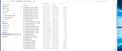

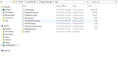

After upgrading our development server to TW 8.5 the log files now pile up in the ThingworxStorage\logs folder instead of being sent to the archives folder every night ThingworxStorage\logs\archives. Is there a setting in v8.5 that I have to enable?

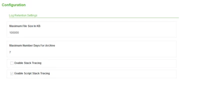

Are you sure there is a setting to tell the system to put log files in the archives folder? Here are the definitions from PTC. I do not see a setting that says send log files to the archives folder at the end of each day.
https://support.ptc.com/cs/help/thingworx_hc/thingworx_6.6_hc/index.jspx?id=ThingWorxHelpCenterDITAFiles-ThingWorxModelDefinitionandComposer-System-Subsystems-LoggingSubsystem&action=show
These are all I see:

With the 7 day archive it should be placing 7 days of archived logs in the archived folder and delete the older ones.
if it is not doing that, please create a support ticket.
