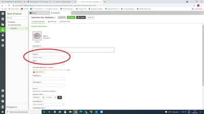

I looking for iniciate examples to connect my esp32 e all sensor boards with Thingworxs.  Maybe you can help in that´s quest, because I don´t uses never before the TW. I know that´s I need creat a User ,and a Key, and thing to receive my request, but the Project Option is empty.

Hi @Telles ,
This is a mandatory field, for this reason either you can select the default project or you can also develop your own project depending on your need.
A project basically is a collection of the objects used to organize objects to which these objects belongs.

Hi! Thanks for answer me!
 The default project don´t appears to me, I will looking for more information, because any acess denied, maybe whitout these parameters.

Hey @Telles ,
Try these steps :
While creating appkey, click on the + button given inside the project field. You will be able to find PTC Default Project.
And if the above given solution doesn't work for you than follow the next step.
Go to projects and let me know if you find any project there.
