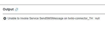

Log Message
ErrorCode(3b19949e-a7bc-45ae-92a4-18bc6a813ee1), Cause(null), Reason(Access was attempted on a null reference variable.), Possible Resolutions(Remove the reference to the null variable within your extension code.)

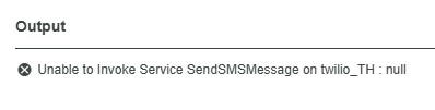

The error messages in the log which you provide indicate that the application keys are invalid.

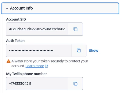

Where you able to get an AUTH TOKEN from Twilio? The values shown in the instructions are not valid values.
Did you get the congratulations message and a new Phone number?

None of the steps gave error in the process.

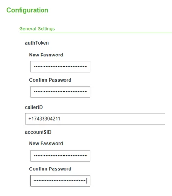

I got AUTH TOKEN, ACCOUNT SID and a TWILIO PHONE NUMBER from Twilio and same I have entered in the Thing Configuration
While trying to send test message I was not able to send it. Shows an error output

I have loaded the Twilio Extension into an Thingworx environment. When I go to configuration, I see the same box's you show in your screen capture.
Just a general question when you entered the phone number you included the "+". I would not expect that to be required.
