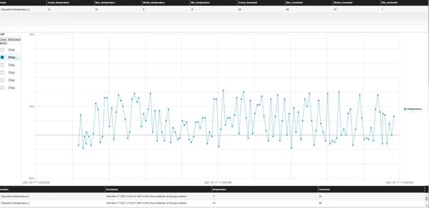

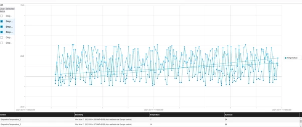

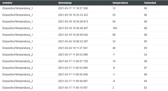

My problem is that I want to choose multiple items in the list and I want  the historical data of the device appear in the chart. I have a service that receive a infotable from the list and get the historical data of the devices selected. The result of the service historical data is the following image when a I put in the input 2 devices.
but I want to binding this data to the chart. When I select the 2 devices I want a line with  the historical data 'DispositivoTemperatura_1' and another with the historical data 'DispositivoTemperatura_2', but if I select 3 I want 3 lines, select 4 4 lines...
graficas.pngIs it posible to do? How?
Is necesary make a service for change the rows data in columns of each device?

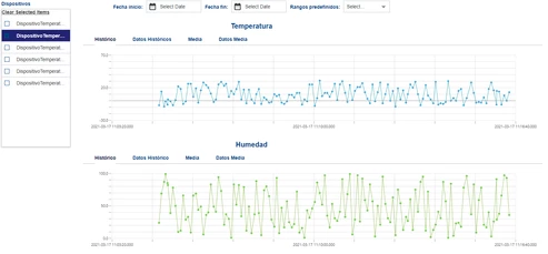

With the service that I said yesterday efectively works and as @PaiChung said it is autoconfigured by Thingworx (I had to change name of one field in the data shape and later it worked).
but now I have another question. Is it posible change the color of each line for device selected?
Remember that my service returns in this shape.
I want the temperature data line of my thing "DispositivoTemperatura_1" in red and "DispositivoTemperatura_2" in blue. How can I configure or what I have to do?

The time series chart should've automatically given different colors per series, not sure if you have some CSS that overrides that. You should see that in the chart properties as it should provide configuration for each series.
The very advanced and more complicated way that I believe is possible is to provide styling/css based on what is selected. I've never done this and this might be a bit challenging if you aren't familiar with CSS
