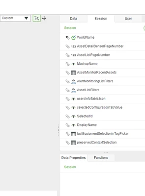

Hello Experts,
I have the same issue :
I don't see the Changed event. I am expecting that when I select WorldName from Session tab the events will show up under Data Properties tab but nothing!!
Youss
Support
July 13, 2021
Hi @YD_9850038
The subject of your post indicates you are running ThingWorx 9.0.2.  This issue was resolved in 9.1.3.
Regards.
--Sharon
July 13, 2021
Thanks for feedback.
I am running Thingworx version  9.1.1-b483
