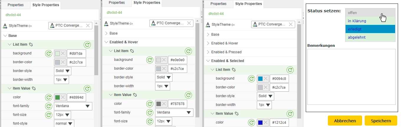

I have a problem styling the list widget in TWX 9.0.2.
As seen in the attachement I set the base color/background to green, hover to grey and selected to blue.
But the base text color seems to be overwritten by the hover color. Is this a bug or am I missing something in the settings?

Hello @Ibisax,
I have tested this scenario and it seems the base text colour is the same as the selected. The base text colour should be dark green when not selecting rows and become dark blue when selecting rows. Only the hover seems to behave properly because it shows background in grey light and Item color/text color in grey dark.

Hello @Ciprian-Traian ,
thank you for testing and confirming that this issue is indeed a bug.
