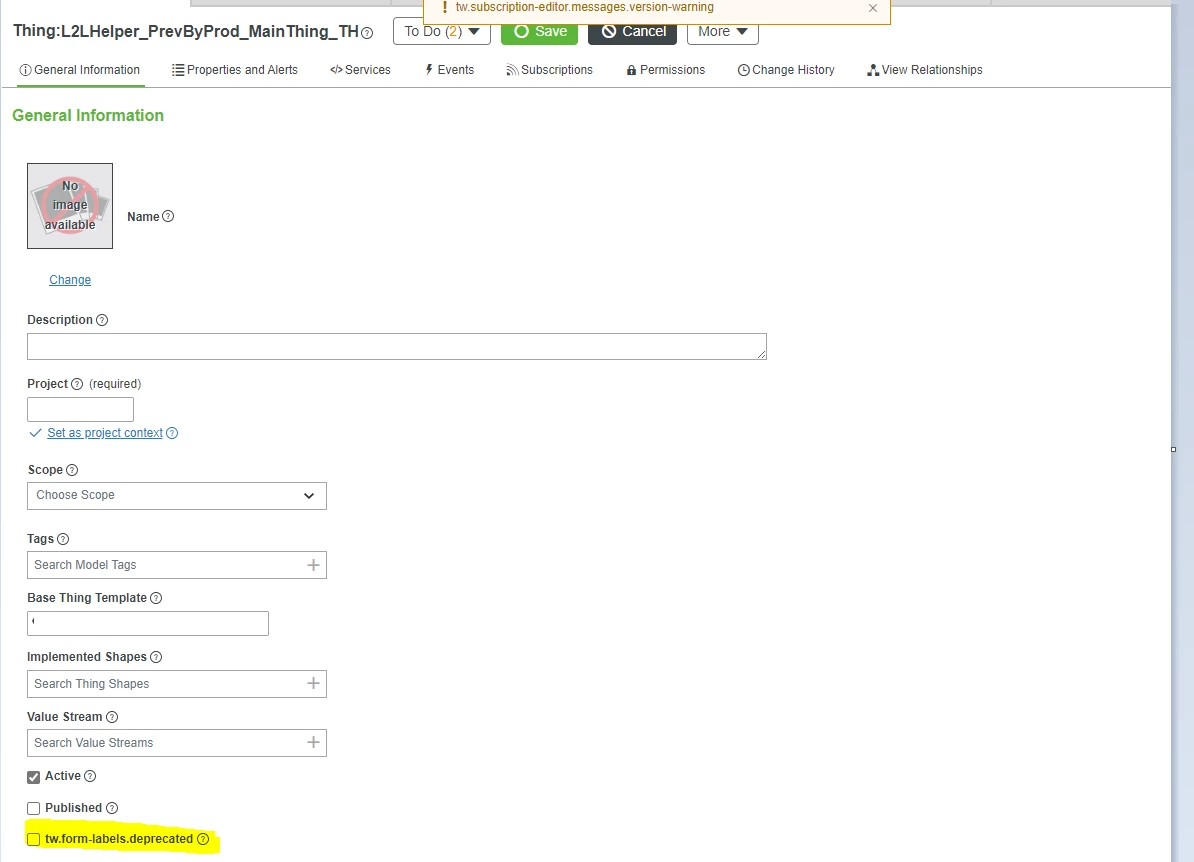

I'm very surprised, because if there were some fields to be filled, usually they had "natural" labels/description, like "Enabled", "Description", "Active", "Published".
But new fields are labelled like: "tw.form-labels.deprecated", "tw.subscription-editor.labels.sequential-events",
(attached printscreen was taken in one of Things / General Information tab). For me, it looks like names of language tokens instead of their values.
Is that intented use? Global bug? Something local on our server?

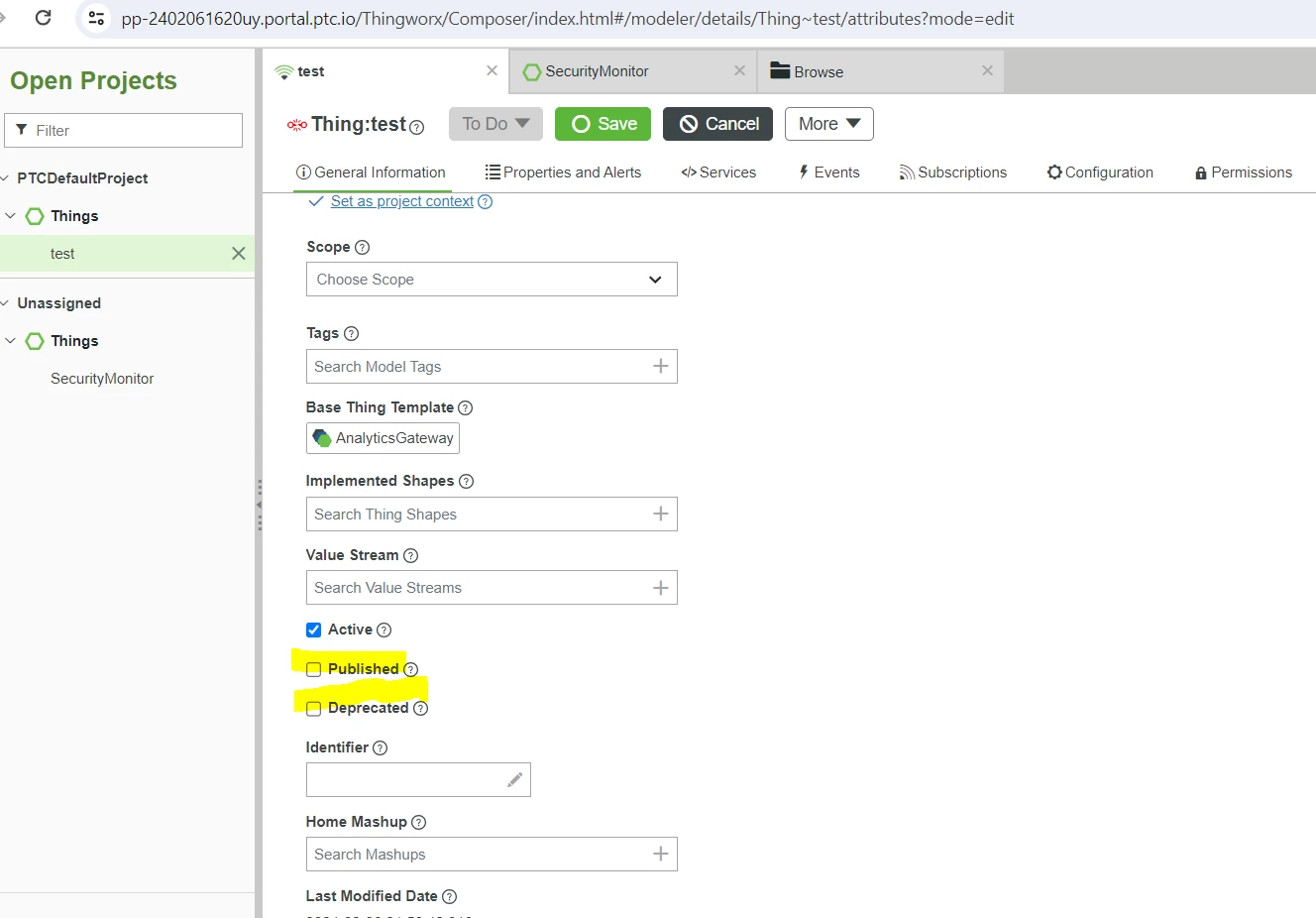

I have checked at ThingWorx 9.5.0 and it looks good to me, take a look at the attached screenshot, have you imported your entities from the older version to this version?

Not exactly imported, they've been there already during upgrade.
So, yes, entities were done in TWX 9.4, no, they were not imported.
Still, it wasn't a reason, it was browser cache issue.

That was the case. I was used to use Ctrl-Shift-R and it was cleaning cache, but looks like Edge did change their shorcuts. I used developers tools with Disabled Cache ticked and refreshed page again - and now it's working.
