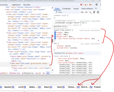

The new grid has a sorting icon that takes up a lot of space when space is limited. I am trying to style this to remove this 8px margin. Any idea on how to remove this?
Alternatively, is there a way to remove the icon completely out of the box and just have the column clickable similar to the old widget?

Hi @JO_9930585,
Please try the following custom CSS. Ensure to verify if custom CSS is still working after you upgrade your ThingWorx.
@supports (ptcs-style-unit: "PTCS-CORE-GRID"){
 [part=hit-area]{
 margin: 0;

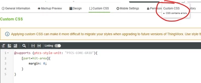

Thingwors is saying this is invalid css and will not let me save this..

Hi @JO_9930585,
Forgot to mention that please turn off the Linting (the toggle button) and you should be able to save the mashup successfully.
