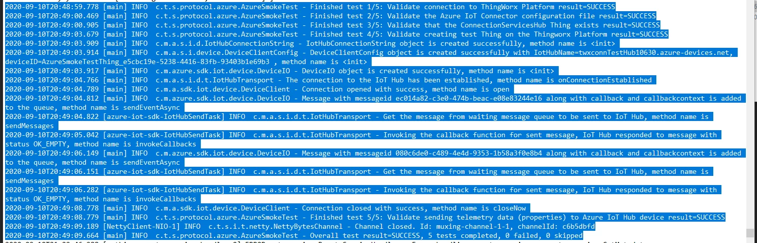

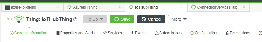

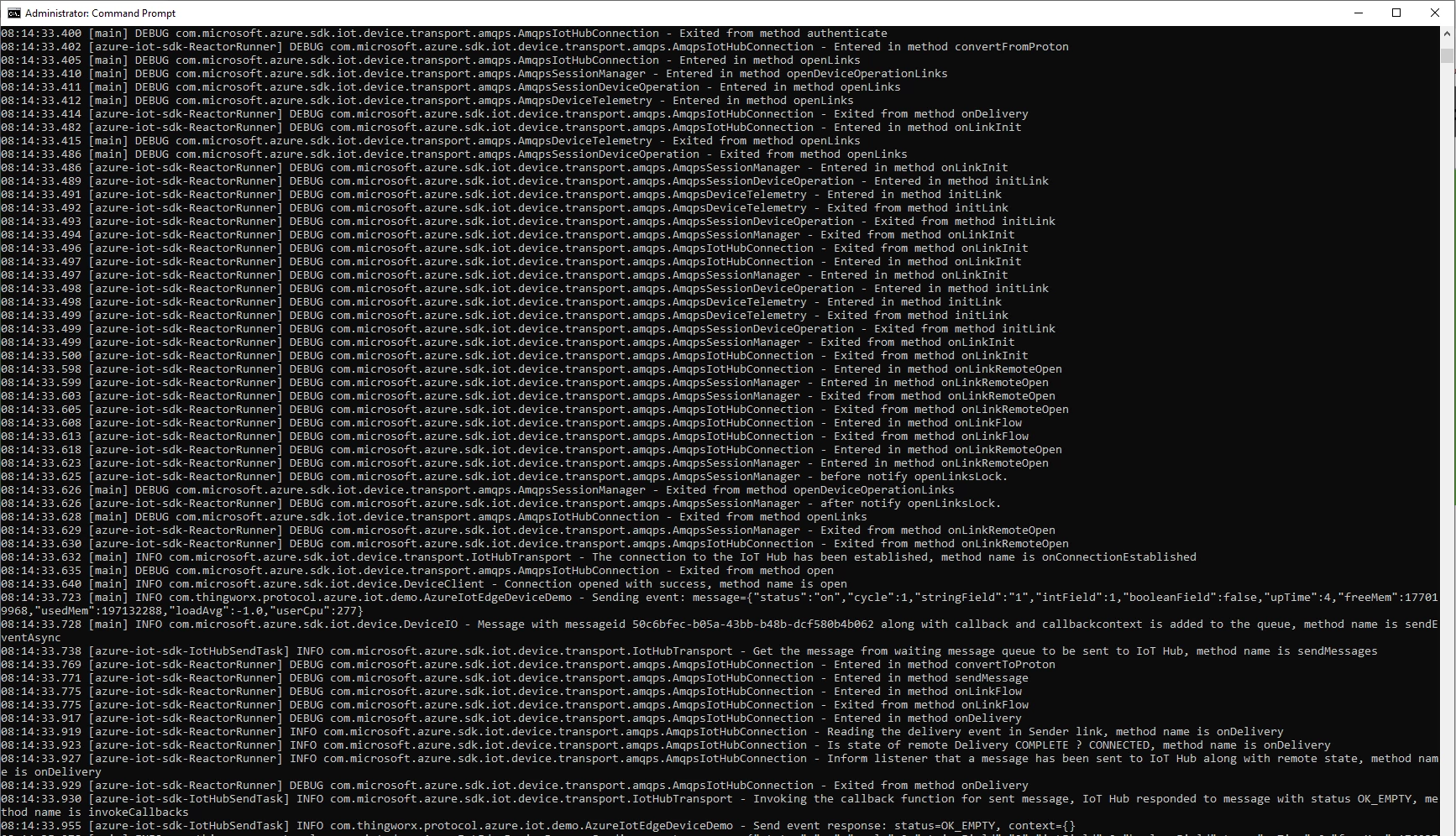

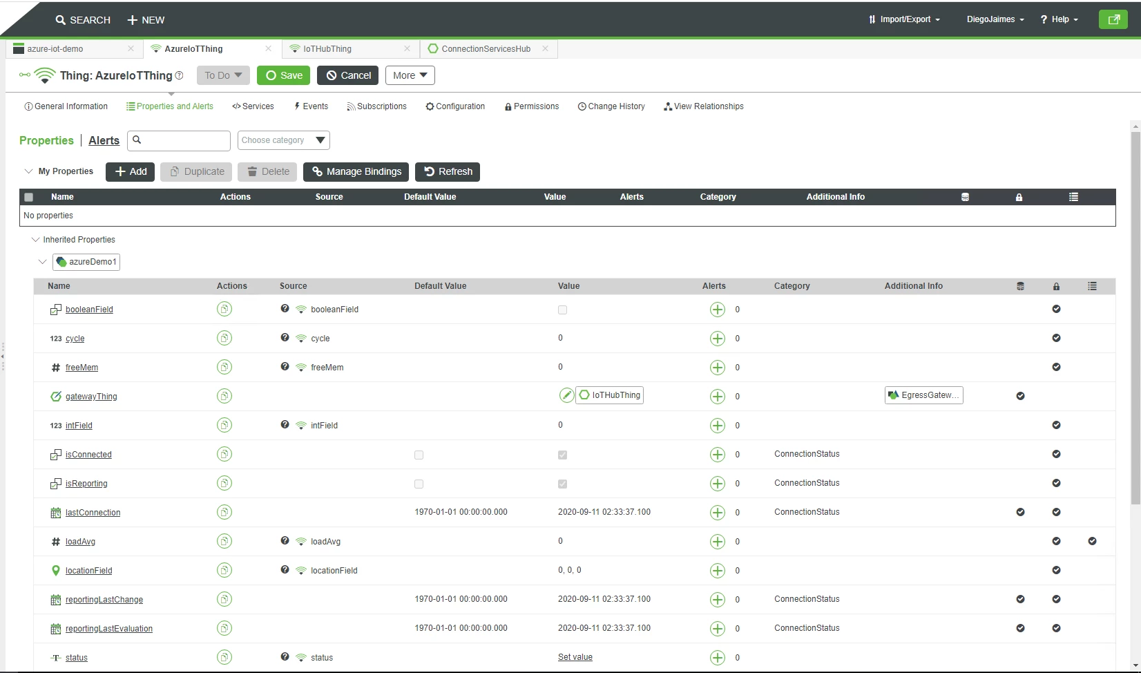

After installing and configuring the TWX Azure IoT Hub connector:
Connector: 3.0
Thingworx: 8.5
I am traying to run the edge-device-demo, but I’m not able to see telemetry data sent by the simulated device from the demo.
Attached you will find screenshots:
  1. Successful execution of the smoke test
  2. The IoTHubThing connected status
  3. The log from the edge-device-demo execution
  4. The AzureIoTThing (demo thing) connection and properties status (not updated)
Can you please tell me what I am missing?

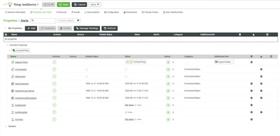

Finally, I was able to run the demo and the telemetry data sent by the edge-device-demo. But now, I am trying to receive telemetry data of an IoT device, I am able to import the device from Azure, but I cannot see the device properties.
Is there a service that I need to run in order to get the properties and be able to see properties updates within Thingworx?
Looking forward to hearing from you guys.
September 14, 2020
@DJ_8712454  ,
You'll need to create those properties in your thing as remote properties.  For example, if your message property is engineTemp, create a remote property in your Azure IoT Thing and set the 'source' to engineTemp.
DJ_87124541-VisitorAuthorAnswer
September 14, 2020
Thanks @nmilleson
That's what i was missing!
