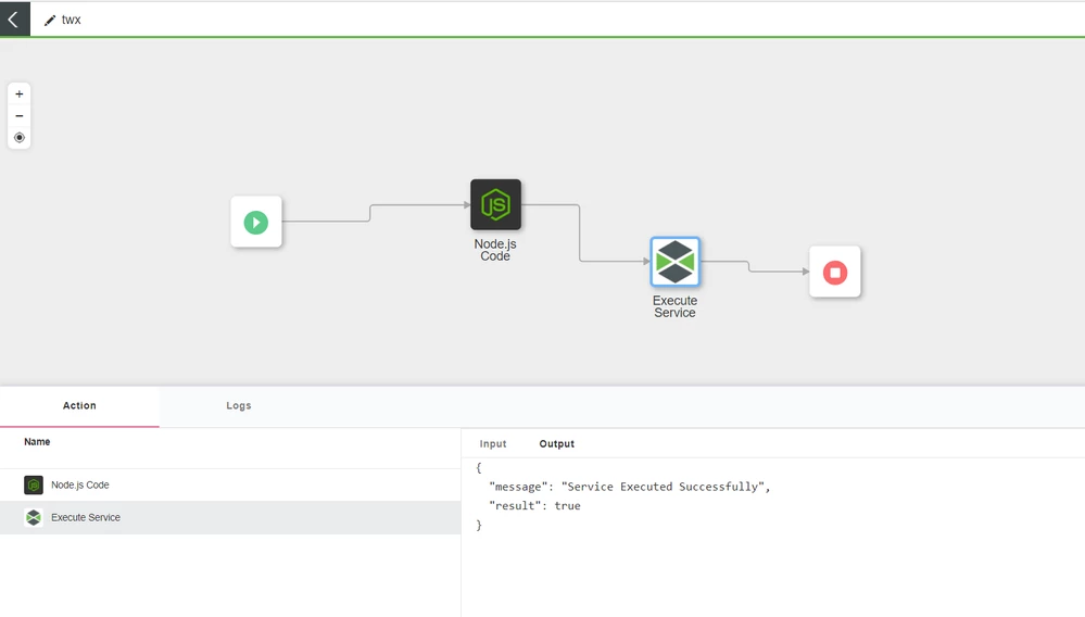

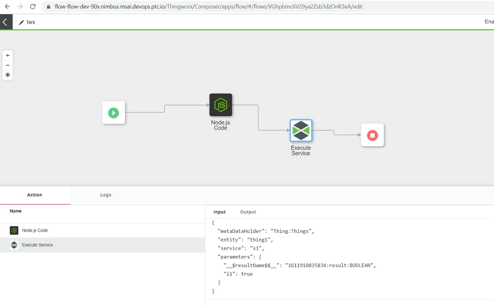

Mar 9, 2021 8:57 PM UTC
Hi Danz,
We created a Nodejs Action that gave a boolean result and appended that result in Service Execute action.
Note: Used option AssignJson
We were able to run it boolean2.pngboolean.pngSuccessfully.
DanZ15-MoonstoneAuthor
Mar 15, 2021 5:36 PM UTC
have you tried using a second parameter? I had problems when using the Assign JSON input because my second input param was getting ignored. The boolean input itself worked fine.
Mar 17, 2021 8:23 PM UTC
Danz,
Second parameter works as well.
Can you send me your entity so i can test it.
Thank you,
Gautham
