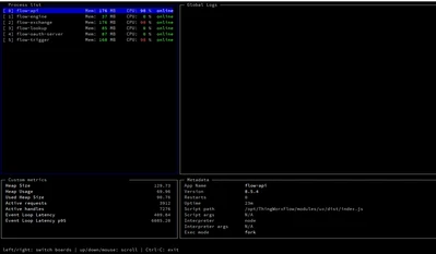

I have a setup with TWXFlow (8.5.4) on a unix Server (CentOS 8).
The installation of TWX Foundation was straight forward and it works.
But the TWX Flow app is, after a while, not responding in Browser.
And on the server itself 3 Flow Services have a very high CPU Load.
pm2 monit
There is only one Flow configured which does nothing (created flow and added 3 nodes, same behavior without any flows)
The logfiles show nothing for solving this problem. Are there any other troubleshooting possibilities to get flow running correctly?

Could you add pm2 logs here to take a look?

here are the Logfiles
i have removed the ones without any content.
The file flow-exchange-error-2.log is realy big (~45MB), also not attached, but there is one message block over and over and over again:
